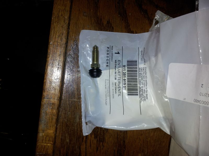

Okay Fellas,
3.2 Front Caliper Bleed Valves are only available from Germany PAG, kinda want not to have to wait :-(
Has anyone tried to use SC valves on a 3.2?
TIA,
Jim

The 3.2 caliper is the same as an SC except that there is a spacer inserted between the two halves to allow for thicker discs so the bleed nipples should be the same

Originally Posted by Ian Comerford View Post
Hi Jim,
PP lists the same Speed Bleeder valve for both 78-83 and 84-89 front calipers (A and wide-A): Porsche 911 & Carrera Brake Hydraulics - Page 1
Useful parts interchange summary, too:
-- 'M' Front & Rear brake calipers are made of Steel and have approximately a 3 inch, center to center, bolt spacing. These were used as front calipers up until early 1975.
-- 'S' Front brake calipers are made of Aluminum and have approx. a 3 1/2 inch, center to center, bolt spacing. These were used on some 911s and all 911 Turbos between 1974 and 1977.
-- 'A' Front brake calipers are made of Steel and have approx. a 3 1/2 inch, center to center, bolt spacing. These were used on many mid-70s 911s and practically all 911SCs. Beginning in 1984, the Carrera used wider versions of 911SC calipers - the 'wide A' and 'wide M'.
Dale

Oh very Cool Flat Six!
Okay, if I am reading correctly:
OEM Standard Bleeder Valves are:
911-351-919-01-OEM Bleeder Valve, front 'A' caliper (sold per each), 911 (late 1975-83)
911-351-919-02-OEM Bleeder Valve, front caliper (sold per each), 911 Carrera (1984-89)
Then if you read the Speed Bleeder Valve Specs, it should match:
Speed Bleeder Valves, "A" Front Caliper (sold per pair, one valve per caliper)
Front 911 (late 1975-89)
I will post my findings,
Jim

Thanks Rnln,
I actually order the front SC valve and new Carrera 3.2 84-89 rear valves, new.
According to the Speed Valve Specs for their front speed valves it is for 75-89 so I am hoping the SC OEM valves will be the same OD and pitch as the 3.2 Carrera valves.

Update:
The answer is weird YES on my 3.2:
911-351-919-01 will fit on both Front and Rear Calipers on my '85 3.2, Does this mean POs or Retard Wrench threaded in a front bleeder valves on my rear calipers? But Why???
The spec on the 911-351-919-01 are 8MM OD thread with 9MM Hex plus Rubber Cap included
Strangely enough, PAG spec calls for 901-352-977-10 on rears but it is way too small in OD to fit in the rear calipers on my 3.2 Also looking at the PAG numbers for the front 911-351-919-02 with out cap
Has anyone else experienced this???
