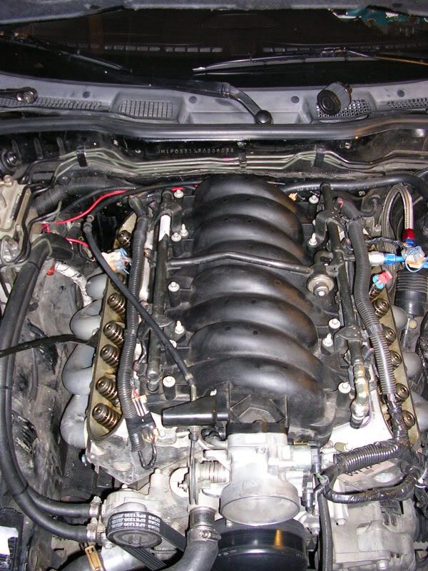

I found this to be the best mod to keep my RX7 running
