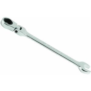

A flex-head gear wrench (12mm?) will save you a lot of trouble when tightening the new exhaust nuts. The bent SSI wrench isn't that helpful.
