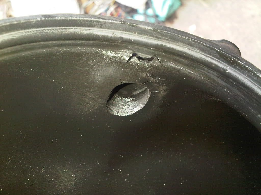

I read that you already checked for leaks, but I dealt with the exact symptoms you're describing so I feel compelled to share what we finally figured out. '82 SC came out of winter storage, had a lot of work done (tranny rebuild, new heating fan, and……pop off valve), then finally was put back together. Started perfectly everytime, but as it warmed up it would't idle right and had almost zero throttle response. We assumed it was the seal around the pop off valve, but after enough checks we were confident it had to be something else…..though no idea what it could be. Drove me crazy.
Turns out there was a hairline crack along the back of the air box that was basically sealed when the engine was cold, but as it heated up & expanded, a lot of unaccounted for air got in the mix. Took weeks to find it.
Anyways, may not be what you're dealing with, but I'd feel like a bad forum member if I didn't share. Good luck finding your culprit.

zacharyminot - thankyou for your post. when the engine was on my engine stand I did give the airbox a serious looking over (but did not manage to pressure test it). i obviously didnt see anything visible so hope its not a hairline crack.

when i got the bus home i decided to double and tripple check everything so i ran the engine and sprayed carb cleaner onto both ends of the intake manifolds, the injectors and around the AAR...nothing.
i then decided to remove the plenum chamber/air boot to check the metering plate and to enable me to see down the back of the engine. having removed it i checked the condition around where the AAR taps into the boot and found this!
i will be ordering a new one. when researching where best to buy one of these, it turns out that the perished boot on my engine isnt the correct one for an SC. i think the perished one i have is an early 911 as it has two connection points close together around the centrelins of the air metering plate. from my research the SC has two takeoffs, but they are not next to eachother.
i will order one of these and see what happens. apparently, the delivery is 7-10days though
