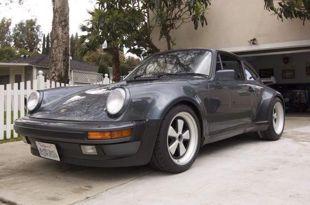

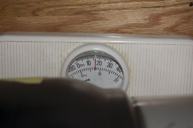

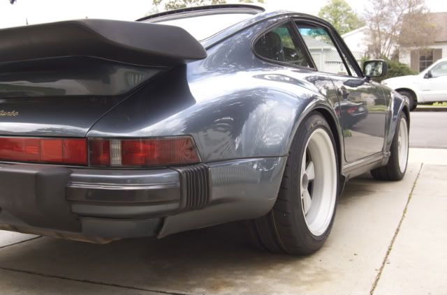

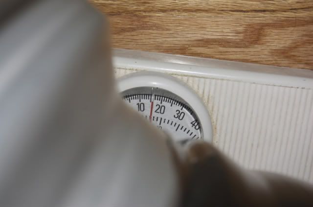

Zuffenhaus 17" (9's and 11's).
Front wheel on my bathroom scale. I think it was about 17 lbs:
Rear wheel on my bathroom scale. I think it was just under 18 lbs:
Wheels on the car:
1990 Black 964 C2 Targa
