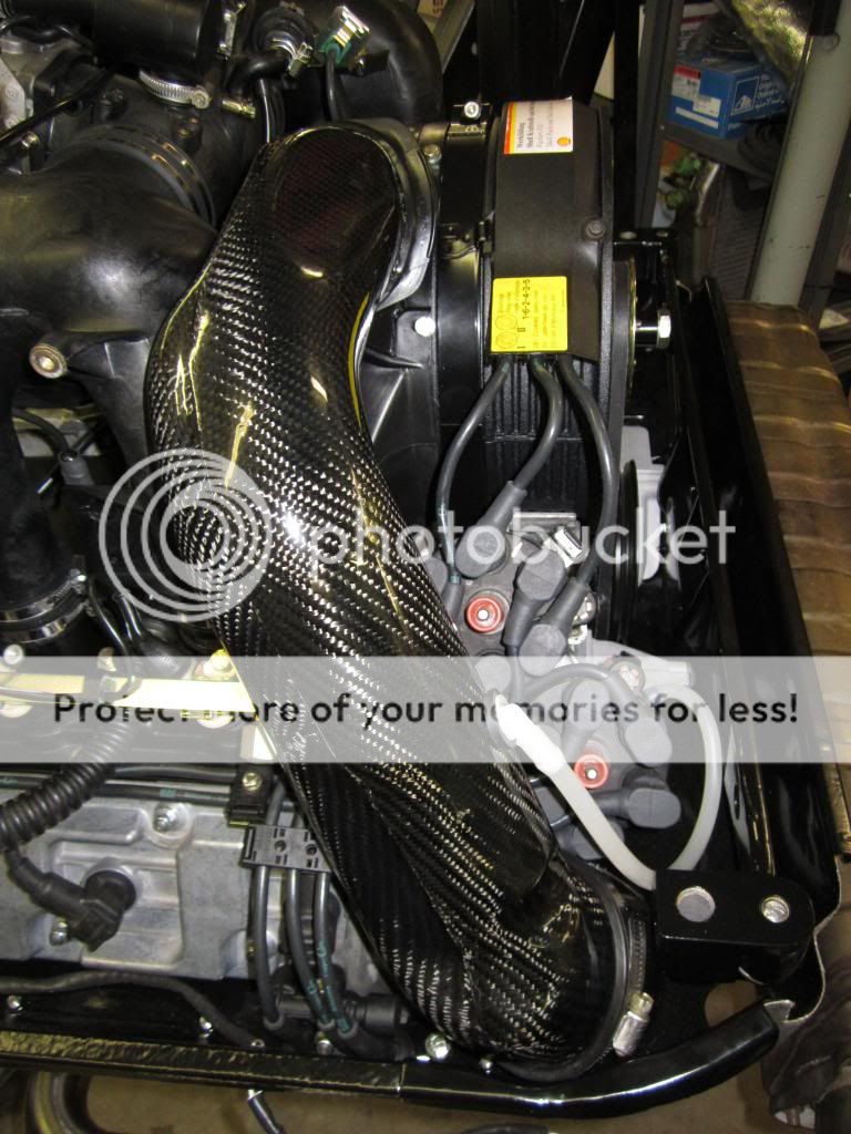

Completion pics & words
Well OK it's Sunday now, just got all the pics and stuff so here goes, and answers to Tom & yes Doug, meet for coffee or something and compare the wee beasties?
Re heat, mine's an '85 (manual heat) so already had the footwell blowers (a small stash has let me cycle them out for TLC until they completely burn up). Silicone Intake Systems provided silicone reducers, SS couplers & clamps to get 2-1/2in SCEET hose (Aircraft Spruce) from the H/Es to the heater valves.
The result, chilly SoCal nights (50's) last week - PLENTY of heat, warm feet with windows down.
I had all three types of fan duct and it looks as though the later 993 type would pass more air (though it doesn't fit the RS bypass tube) as it has a larger plenum - see pics below.
So maybe without footwell blowers, adapting the 993 part or using a SCAT/SCEET adapter duct might work a bit better than either 964 part.
So back to bypass tube, it was clear there was less clearance than some other conversions, engine mount geometry maybe? I don't know, but get the CF bypass tube in with this car:
1. Cut about 1/2 inch off the lower end as it was too long to insert fully into the receiver. But now it didn't reach the air duct, so…
2. Cut it in two a couple of inches above the distributor vent line port, centered on the roundest section.
3. Added a 3-in (nominal size) rubber & SS pipe coupler sold for ABS pipe, $6 at HD. At first I used the SS clamp on top but after playing with all this stuff a bit decided it was unnecessary, and used only the rubber sleeve.
4. Cut out two oval openings using hole saws and files, one to clear left fuel rail, the other to clear the left rear engine-mount gusset.
5. Taped some reinforced rubber material over the two holes with 3 mil x 1-1/4in harness tape (stuff is used for wrapping truck and vehicle wiring looms - conforms well, modestly heat resistant, and the glue/tape doesn't smear/slide) - but this is while effective not going to be the permanent solution (three years later…)
6. While the plastic cover over the relays and fuses is shown IN, and tube can be inserted with cover there, cover has to be removed to provide clearance for rotating the tube into place. With no lower gasket in place, inserted tube in position shown in pic; rotating CCW and back put it into position and removing several times to adjust the rubber sleeve fitment for length and angle re the air duct, then removed it again. Without lube, it grips the tube tightly and is not easy to relocate.
7. Positioned the loosened lower clamp as shown in pic, with the end lifted over the finger on the receiver as shown in pic, and placed the nut driver with flex drive as show.
8. Liberally sprayed the rubber lower gasket, receiver and bypass tube end with RZ-50 dry-film lube.
9. Inserted gasket in receiver, then started the tube in position shown above (with cover removed as in 6 above), and with only minor wiggling during insertion & rotation (innuendo fodder) CCW and back into position, it seated perfectly, including the lower rubber gasket, and easily fitted squarely & firmly into the air duct.
10. Tightened the lower clamp with the pre-positioned nut driver (removed tool).
11. Inserted distributor vent nipple & hose.
So now clearance on both sides, doesn't rub on fuel rail or engine mount gusset. Even with temp. tape job, not too ugly...
12 Job done! (Apos to Wheeler Dealers).

Barry -
Thanks for the write-up & pics. While I certainly cut up my CF tube to fit around the motor mount, I never thought of slicing it completely in half to help make it fit w/the angles etc... Maybe I'll give that a try.
Thanks again for taking the time,

Tom, here's the exact part I used, Home Depot, Fernco 3in neoprene shielded coupling, Model # P3000-33, Store SKU # 482152. It's a shiny, clean part (see my photo) and the SS sleeve part fits fine too, if you want to use it, or just the hose clamps, they are 100% SS type. At HD it's $8, not $6, my bad. Just rechecked size, my Maxspeed CF tube ($180, our host had no OEM or CF tubes at the time) is OD ≈3.75 in the roundest portion, and the 3-in coupler fits very well - the 4-incher is too big (two trips on that one). Intercooler Pipe Fabrication - Silicone Intake Systems Auto Parts sell all manner of silicone parts for similar $ but tough to know which sizes if any would stretch or squash to fit well without trying.
Good luck!
