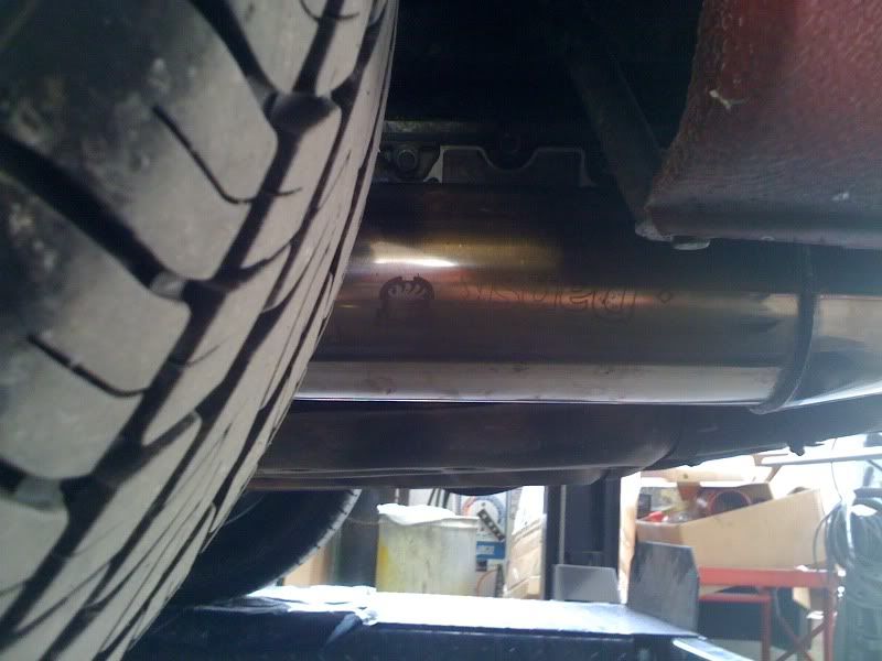

All this talk about bypass's - I decided I'd buy one. I then worked out I should get a proper jack support and while I'm at it a new 02....$$.
After buying all the goods and removing the Cat - I discovered the guts had been removed anyway. So the job came down to cosmetics and a fun hour tinkering with the car.
The package was wonderfully boxed - thanks PP
Some tips:
1. The Fab Speed bypass comes with gaskets and bolts/nuts - the bolts are a different hardness to OEM - not sure it matters but the length of the bolts do and 3 to 4 thread lengths to short (I'll replace the bolts when I fix the rocker gaskets/leak).
2. Remove the wheel (LR) - I didn't to start with and by the time I mucked around maneuvering myself to get a swing at some of the bolts....I simply came to the conclusion to remove the wheel anyway.
3. Consider an oil change (and rocker gasket) while your at it, with the cat out of the way things are easy to get to.
I have the following pictures.
