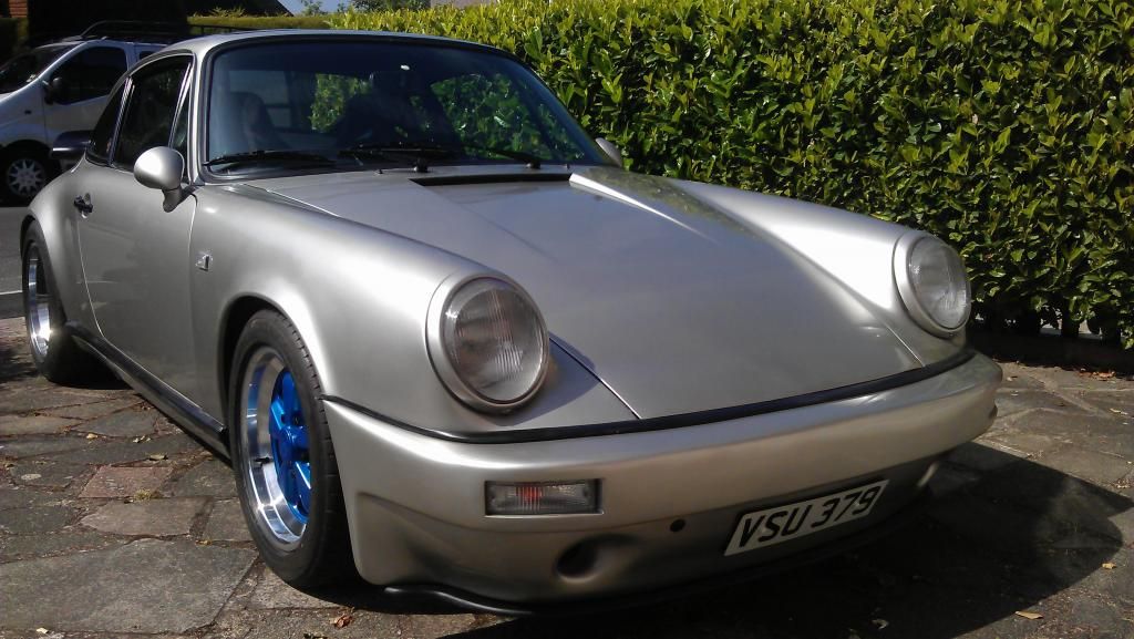

I have a dumb question, and in making a picture to illustrate my question, I noticed a detail on your car, so I also have a comment.
First, the question, since you used a mold of the factory front valance to fill in the oil cooler opening in the IROC bumper, how does the height of the factory valance compare to the IROC bumper. Is it shorter, taller, same height? I'm talking about the measurement illustrated by the red line in the picture of your car below.
While resizing the picture and adding the red line, I noticed your mirrors. Very nice. I like the way they look a lot. Do you like them from a functionality standpoint?

Hi Again,
The height of the "valence" area on the IROC bumper I used as a starting point is the same as a factory valance plus the rubber spoiler lip. The filler piece I moulded from a factory valance did not fill the hole all the way down, but as it was a narrow gap it was easy enough to face it with some card and lay the FG up behind to fill it.
Mirrors are Vitaloni Sebrings on modified Cup bases. Functionality is fine, although not as much visability as the Cup mirrors I used before.

Mark,
Thank you for the speedy reply. So you have similar clearance to a stock front bumper, exactly what I wanted to hear.
I figured you used Cup bases. I think they look cleaner than flag bases. I built a 3D printer and I want to use it to print a low profile base for my Vitaloni's that just covers the holes in the door, but have a similar profile as the base of the Vitaloni. I'll make my own gaskets. I plan to sand and paint both the bases and Vitaloni's to give them a nice finished look, as you have done.

So you have similar clearance to a stock front bumper.
Yes, similar clearance to stock without including the splitter, about half an inch less clearance including the splitter.

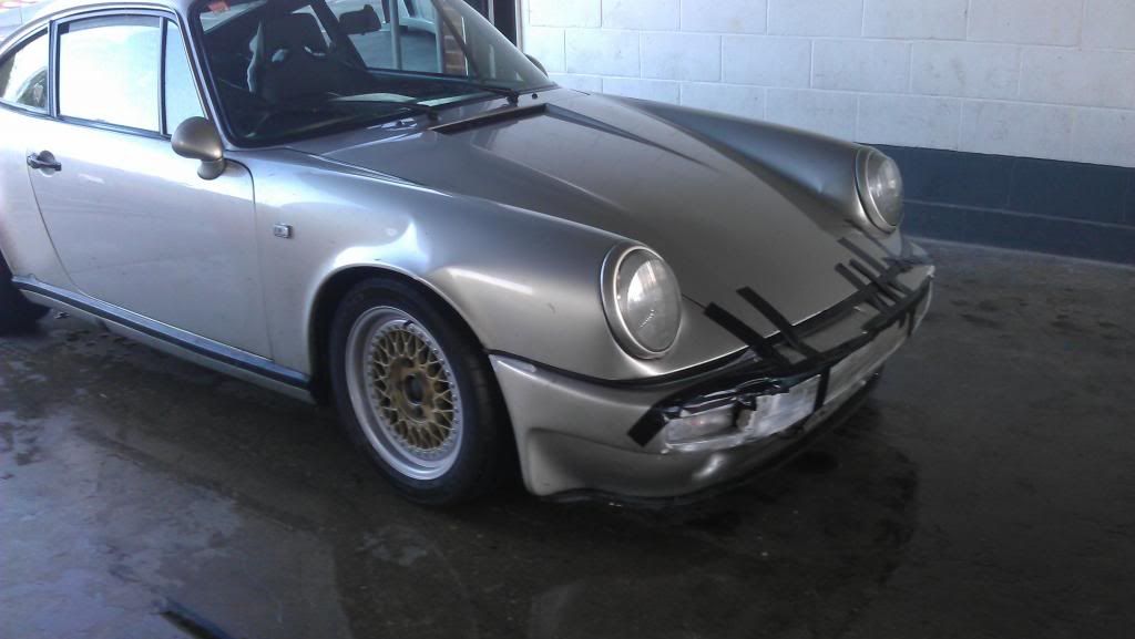

Thanks for the various positive comments, unfortunately I am currently having to rebuild the bumper after some impromptu crash testing.
A combination of a wet track, over enthusiasm, a pit wall and just about 90mph meant I went from this...
... to this ...
This was a couple of weeks ago and the reassembly is well under way.
I had a helmet camera running at the time, it was a bit misaligned, but you get the idea from what it showed.
  • Out of a corner with the rear end settling and griping fine.
  • Increasing power on the exit heading towards the pit straight still feeling settled.
  • Just as I reach the exit point and 6,000 rpm (at 22 second in the vid) the back moves.
  • I keep the power on and steer in, but there is not enough room between me and the start of the pit wall.
  • Bounce off the wall, full on the brakes, full 360 and there's that wall again.
All part of the game I guess!

All fixed now!
Mark
