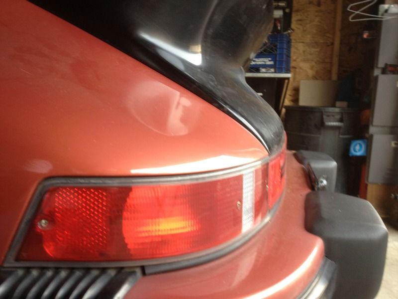

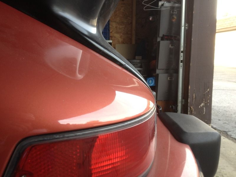

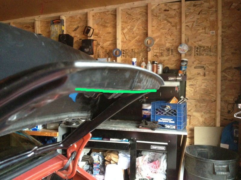

yep, i was referring to grinding/trimming down the under side of the tail at the bottom, where it meets the rubber seal.
i think the pics make the top edge look worse than it is. it actually looks pretty flush along that edge, and with a couple washers on each side the corners match the body well.

Sounds like you have it covered. Typical ducktails on the market today should be thought of as a copy of a copy of a copy. The originals didn't fit perfectly.
Most copies seem to leave big gaps along the sides.
In the past, I've tried replacing the cast "frame" on fiberglass ducks with a stock steel frame, hoping the fit would improve. But that brings its own set of challenges, including separation of the fiberglass from the steel (this is an area that heat cycles a lot). Good luck. I think you're on the right track. Please share progress pix.

just to be clear this is the edge i am contemplating trimming. it appears to be the one that is causing the tail to stick up when the rubber seal is installed but i will know for certain in a couple hours when i can get out there.

I have only done this once and I'm not a body man but it is all about "splitting the difference". Especially if you are not going to grind and fill the edges with FG as most manufactures would suggest.
You seem to have washers only under the front (top) hinge holes. Try stacking another washer or 2 under the front holes and then like maybe 1 in the lower hole. This may lift the bar you want to grind enough and still be OK with the under the window and qtr. flush fit.

i'll give it a shot but i don't think that will solve the problem. by adding washers i will be raising the front edge, which doesn't need to be, an doing nothing to help seat the tail lower over the rubber seal. thanks for the suggestion though.

didn't get a chance to mess with the duck today but for comparison here is the duck with the rubber seal in place.
and here without
getting there.....
i happened to go to a local track today where my pca was hosting a de event. there were a pair of 911s sitting next to each other, both with ducks. one sat fully flush with the quarters and the other was slightly raised like in my last 2 pics above (the sides). after seeing them both in person i have changed my mind and like it sticking up a bit along the side. i can't tell you why, it just looks better to me. luckily that way is a lot easier to achieve in my case

finally figured out the problem. the duck was for an early car as it had the area on the bottom (under the lower lip) to mount the license plate lights. instead of cutting up the tail i removed the rubber strip and replaced it with some foam that the tail can seal up against.

this is the edge i was talking about
here you can see where older style license plate lights would go
