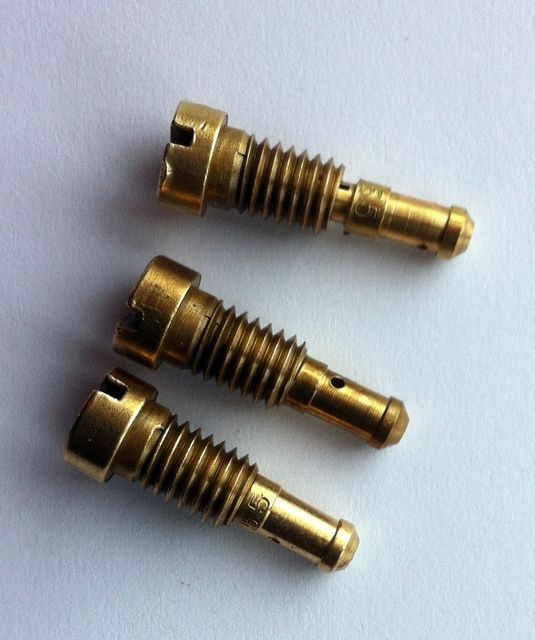

So gentlemen, I have a mystery on my hands.
I`ve had the manifold welded and put everything back together but as I tune the engine the idle mixture screw on number two is unresponsive. Using a ColorTune reveals a yellow flame on number 2 that becomes a blue flame as the revs climb to 1600 but as I say, at idle the mixture is too rich and the idle mixture screw has no effect. The plug is sooty when pulled after idling.
A leakdown test shows acceptable results, if anything number two is better than one and three.
A compression test shows uniform results at 165 psi
There are no manifold leaks.
Swopping the idle mixture screws around makes no difference.
Plug leads are Newish Magnacors, swopping lead for lead has no beneficial effect. I have MSD fitted and the spark is excellent.
I`ve checked float level in carbs, the meniscus is between top two marks on gauge when the engine is running. I tickled the floats... and they are happy.
I`ve peered down the venturis with a mirror and flashlight and there is no untoward flow of fuel.
the idle jets are 55`s, new this week.
The carbs were professionally stripped, ultrasonically cleaned and serviced 2 years ago. I`ve had them on the bench, stripped and cleaned them with carb cleaner and compressed air this week... even the secret gallery. I`ve burnished out the divots and the floats are not compromised.
The Hardy pump delivers at a steady 3 1/2 lbs.....
.... not that that`s going to be the problem... just trying to be thorough.
Now I like a mystery as much as the next man but on this occasion I would appreciate a second opinion. And third and forth.
Any thoughts why my number two screw doesn`t work ??
Regards, Mike.

If you have early IDAs then the idle jet holder does not use an o-ring; later Webers have o-rings. If you have a later style idle jet holder and are using it in an earlier Weber then the idle jet won't seat properly and will allow ultra rich idling. Upper jet holder is the o-ring type.

My carbs are `68 IDS`s and there are no O rings on the jet holders. I`ll check tomorrow and see if I have an errant later holder... excellent photo, thankyou very much.

Morning Paul, I felt sure we had the answer there for a moment... but alas, all the jet holders are all the same non O ring versions.
What else could it be.
Regards, Mike.
Edit to say, I should add that idle screws appear to be in good condition, identical and swopping them around changes nothing.

Drat, I also thought the issue was the jet holder.
Check to see the idle air bleed hole isn't blocked with the gasket or with a bit of debris. This is the brass "pill" that is just inboard from the idle jet holder and is pressed into the top of the main throttle body. If blocked it would enrich across the progression so I doubt this is it.
Are you sure all lead plugs in the fuel galleries are in place? When I service Webers I peen all lead plugs (including those in the tops of the accelerator pump jet bolts) after ultrasonic cleaning. They do loosen on occasion as a result of age and from the cleaning process.
There isn't much else I can suggest, a very interesting issue you have. Perhaps you could send it to me to have a look? Contact me via my email address if it comes to that.
By the way, without the Colortune you wouldn't have been able to provide the diagnosis as absolutely as you did; definitely rich at idle, leaning with increasing revs and a good spark. The tool is wonderful in this diagnostic role. I'm glad you have it to help focus upon the correct issue and (eventually) verify the issue is resolved.

I suppose spraying each lead plug with carb cleaner, one by one, as the engine is running, cold and then hot, is as good a way of proving their integrity. All seems well on that front.
The idle air bleed pills are clear.
You`re right about the ColorTune, it gives me a certain peace of mind that number two cylinder is firing correctly once I get underway and for now that`s enough for me. The car is running well generally and whilst we have a bit of summer left, I`ll enjoy her while I can.
Thanks for all the help, I`ll try and get the carbs over to you over winter for a level 1.... maybe even a level 2.

I had a project that the idle mixture on one cylinder was so rich that it would not even fire. What I thought was a "not enough fuel to fire" issue" was in fact a "too much fuel to fire" issue. When I investigated I found the mixture screw tip had broken off in the orifice and a previous repair actually shifted the hole to the side and enlarged it. I repaired the issue by tapping the wall and installing an aluminum, threaded plug; M5x0.8. I then drilled a new orifice and removed the stick-out from the inner bore. Once this was set right the issue went away.
Perhaps you could have a look for this issue? Also, I assume your mixture screw is the same as for the other cylinders and not buggered in some obvious way. Try removing the spring from the body of the screw and see if it allows it to seat deeper. If you are using the cup washers with o-ring seals then there may be the issue of grounding out on the spring/cup washer stack-up before the needle seats in the hole.

Hi, it`s been a while but I`m able to report back about why adjusting my number 2 idle mixture screw wasn`t having any effect. As it turned out , the number six screw wasn`t responding too well either.
I stripped the carbs and removed the lead plugs just to make sure but didn`t find anything untoward. I Changed the plugs, measured the leads, checked the valve clearances, put everything back together again and.... Same as before.
As a last ditch attempt to try something I decided to replace the points with a Petronix I have for this distributor and it was then something turned up.
The rotor arm was loose on the distributor shaft. Not much, but enough.
I bought this distributor off US ebay after searching for the correct one for my car for a few years. It was NOS but I had the vendor send it directly to a specialist in the States to have it serviced and the curve checked before sending it on to me here in the UK.
It arrived here a few weeks later as a plug and play distributor... so I did.
It seems unlikely that a loose rotor arm would have such an effect on number 2 and number 6 mixture screws but wrapping a bit of black tape around the distributor shaft so the rotor arm is a good interference fit has cured my engine problems completely !!
Now I can tune the car accurately and there is no missing as there was before.
It's a miracle.
So after spending a summer tearing my hair out, thinking I should buy a new MSD or some new PMO carbs or at least have the engine rebuilt, it all came down to 2 inches of black plastic tape.
Now I get to enjoy fine tuning my engine and see just how good I can get it. The thing that has made the most difference over the last couple of days has been adjusting the air flow balance @ 3000 revs by adjusting the cross bar brackets. Never done this before, thanks Paul.
