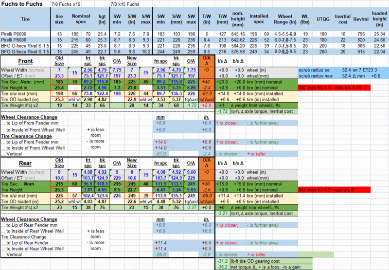

Bill Verburg 05-27-2018 04:54 PM
old thread, but yo can address 2 issues w/ one change
while a 3.6 is nice and gains you ~50 lb-ft of torque and losing 100# is like adding 15lb-ft of engine torque, and regearing will have a similar effect all are intrusive and expensive.
Change to 15" wheels can add ~45lb-ft(near what a 3.6 adds)
here are a couple of possibilities
http://forums.pelicanparts.com/uploa...1527465198.gif
