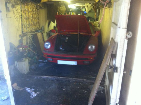

First step was was removing it from the garage where it had been parked with the handbrake on.
13 years of dust, household stuff piled on top, this is the first time it had seen daylight.

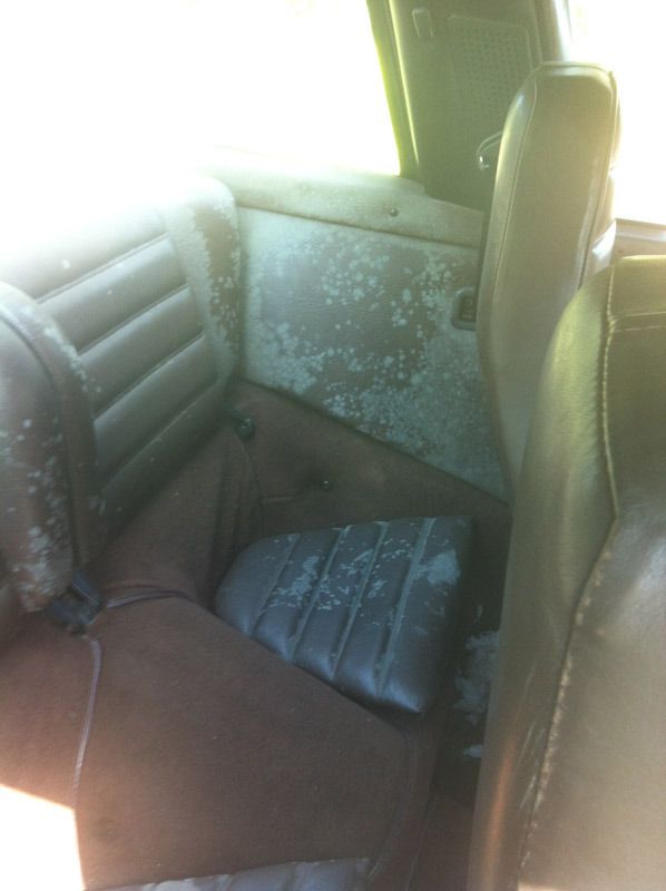

Interior not looking so pretty

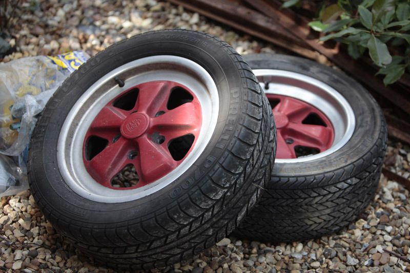

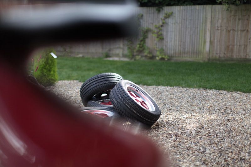

New rubber needed, these are old, mismatched front and rear and some N rated, some not. The alloys will need refurbing at some point, but I need to refill my wallet first.

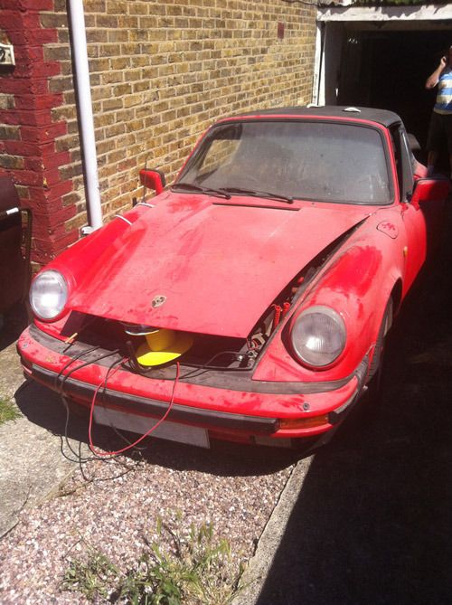

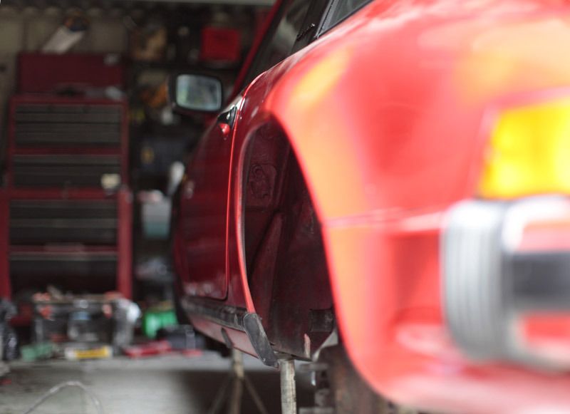

She's pretty straight all over
It looks like a PO had the car fully undersealed, I've checked all of the usual floor plan areas, headlight bowls, rear deck lid and they are solid. There are a couple of small bubbles by the rear windows, one by the bottom of the front wing near the bonnet and a split in the paint caused by something heavy.
Unfortunately the PO thought he was a wiring guru, he was wrong. I'm surprised the car hasn't caught fire from what I've seen!

New rubber, Contisport Contact
