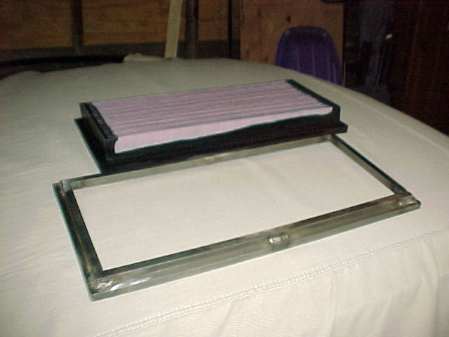

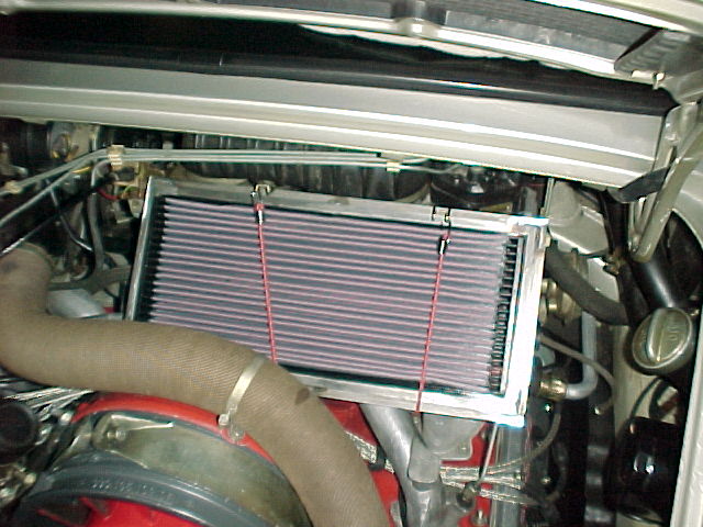

I got to thinking the other day about how to get rid of the airbox lid and that little tiny snorkel and make my engine a little more free-breathing. I came up with this:
It's basically a frame that holds the air cleaner to the top of the airbox. The frame is held in place with 2 small bungee cords.
It's only good for fair-weather driving but a roof could be added to it for wet weather.
I made this one from of steel just as a prototype. Next week I'll make another one from aluminum.

If the idea was to reduce intake restriction for performance reasons, it won't do anything because all 911 tuners agree that the only flow restriction on your motor is on the exhaust side. One look at the size of that stock air-filter tells us that. K&N filter actually reduces HP on this motor, according to dyno tests. I do admire your hot-rodding spirit, but that is the wrong end of the pump.

What makes you think that removing the "little tiny snorkel" will make your engine more "free-breathing"???
Well, the engine is limited by flow through the stock exhaust, which I've already done away with. Where the restriction is now I'm not sure as many of the "tuners" aren't sure either.
As for the K&N, I hear all sorts of things and see data supporting both points of view. I bought it because the paper filters didn't seal worth a s**t.
Either way I figure it makes sense to try to leverage all of the easy things first before I spend cubic $$$ ripping the engine apart.

Basically you just have to look at the square inch area of stock air-filter/ displacement of engine, (3.0 liter or 181 cubic inches), there ain't no flow problem there. I've seen 400cu.in. V-8's with smaller air filters. (And they ran good). I don't have an engineering degree, others here do, but when it comes to air flow in and out, there is an optimum restriction and it isn't zero. Otherwise all race cars would have NO EXHAUST whatsoever, headers would not exist. Stock exhaust is a little restrictive on our cars, but if you reduce back-pressure too much, you start going backwards in the HP race. You say that you have seen "data supporting both points of view" in regards to K&N filters on 911SC's? I would like to know the source of data showing HP increase over stock, it would contradict (unbiased) dyno testing done by members of this forum.

Actually, once you remove the exhaust restriction, the next bottleneck is downstream of the filter. From the sensor plate south, it's pretty convoluted.

Blue sky, Thanks, I forgot to mention that: the big restriction on CIS cars IS sensor plate, (as opposed to air cleaner cover), now if someone can just figure out a way to eliminate THAT THING.

Seems to me that the real bottleneck is those little bitty intake valves, and the small amount of time that the cam allows each one to be open.

In my Bosch fuel injection book (Probst) there is a chapter on performance modifications to CIS. Most of the chapter is devoted to lists of things that people have tried. It includes stuff like boring out the throttle body, using the cold start injector for creating a richer mixture at full throttle. I think it even describes using a larger sensor plate (I may have read that elsewhere). None of the modifications listed made more than a 2-3% improvement.
Not to criticize your efforts, but if there was any easy hp gain to be found by modifying the air intake, I think the engineers at Porsche would have found it.
