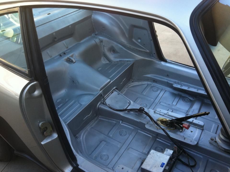

i would love pictures if you wouldent mind, what year car is yours?
i also am wondering if you can put a 5 point harness on the passanger side of the car, it looks like the bars will be in the way-
the car is a de/weekend car, i was going to do a full cage however i know it wasnt safe for the street, so the roll bar was the next option.
heres what it is going into- the pics are a few months old- there are some new changes, tearing wheel, dash- ect

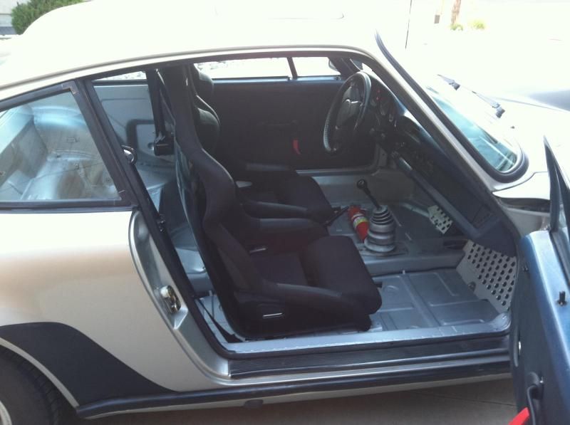

Wow Tom, you got your seat low in there. What mounts / sliders did you use?
I cut out the OEM slider mount locations and welded in some new cross members between the center tunnel and door sills. Works great.
Here's some pics:

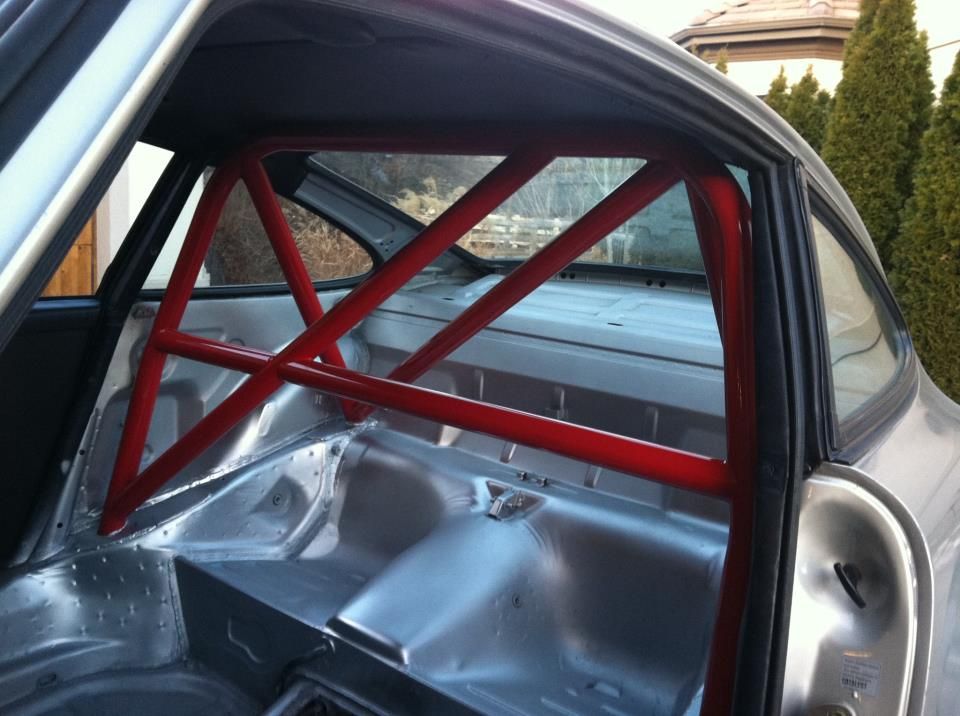

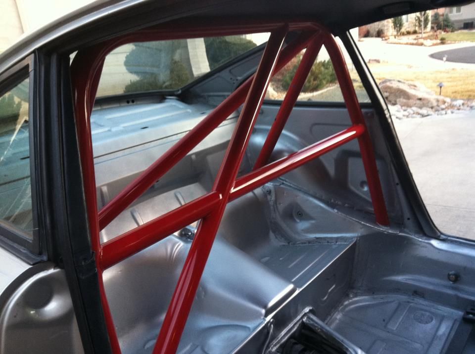

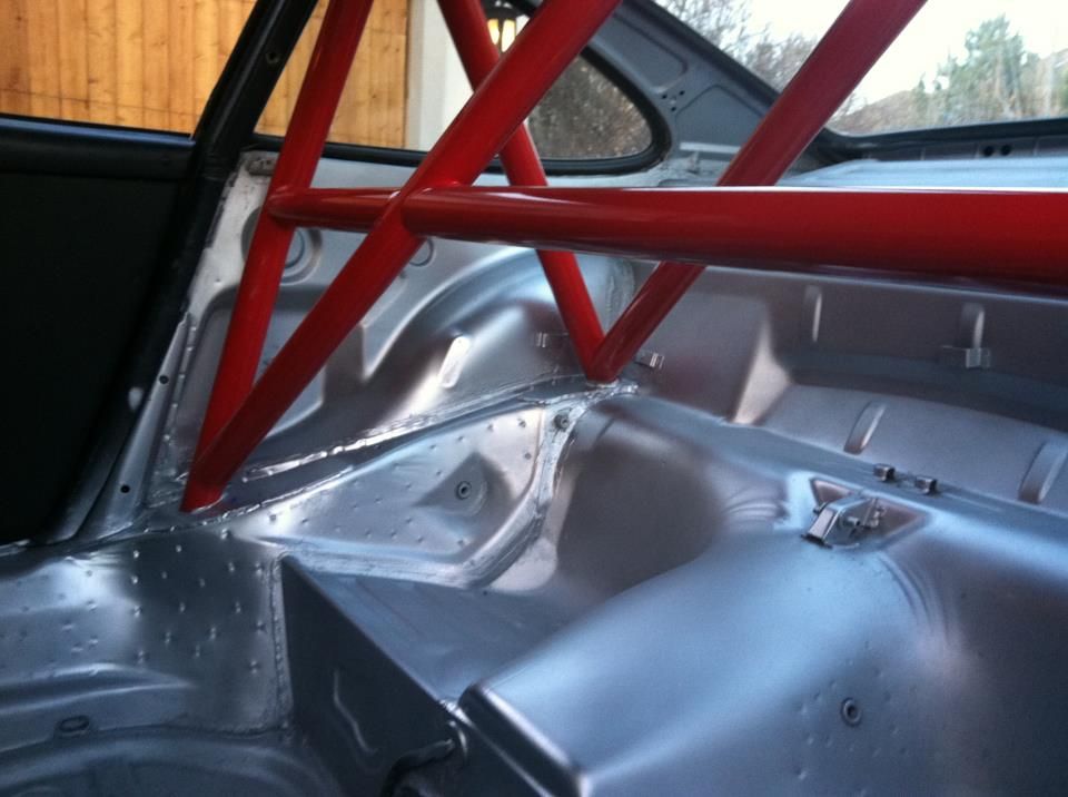

thanks again everyone, took a few hours for the install, overall im very happy with everything.
here are a few pics, let me know what you think
