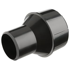

I just got the pieces for my car. I've got some existing 2" ducting up by the rear seat. And I knew I needed 3" ducting to wrap around the exits from the exchangers. So I got 5' of 3" Webasto 'High Temperature Ducting' from a place called Sure Marine Service in Seattle. It was $25.
Then I got a pair of 3" to 2" reducers through Amazon. They'll let me mate the two together.
They were $6 each. It bugs me to pay $37 for all this stuff, but what are you going to do?
I'm putting in new axles next week and I figured that would be a great time to do the ducting. I'll post how it works.

Yes, 3" tubing will fit over the oval exit port from the heat exchangers. I used an ordinary hose clamp.
I used a reducer to my existing heater tubes. My mistake was to assume they were 2". They're actually 2.5". So I just kinked it shut.
