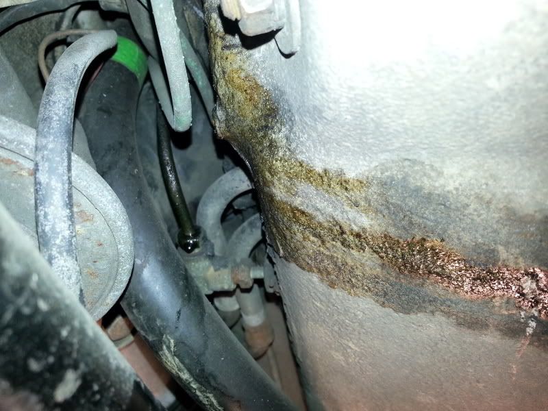

Also check all your brake lines not just at the calipers but behind the stone guard at the t & elbow connectors, A leak there, you will never get the brakes hard:
