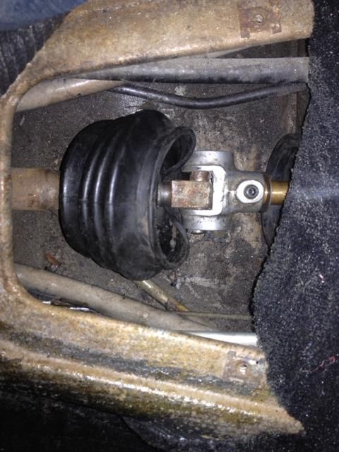

Went to back my car out of the garage, and it wouldnt move, although RPMS would drop as I let out the clutch like it was in gear, but didnt have enough power to move the car. This was in any gear I tried. But then when I put the shift lever in neutral, the car would reverse! If I put it in reverse it wouldnt move.
Where do I start with this one?

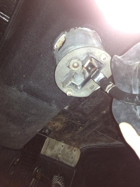

Okay did a bunch of searches, and led myself to find my shifter coupler bushings were completely gone!
Phew, some of the other possibilites I read on here scared me. Guess Ill be working on the car today instead of driving it.

I was about to say - crumbled coupler bushings

The shifter in the photo is a 915 shifter,not a 901.

looks like a 915 to me and man you have no coupler bushings at all...I'm surprised you could find any gear!

Here is what you will need. 911 424 139 00 quanity1, 911 424 223 03 quanity 2, 914 424 224 00 quanity 1. That should take care of the bushings.

Yes, the coupler bushings must be changed.
But -- The fact that the car would not move when you selected any forward gear tells me that the transmission is stuck in reverse, and when you selected a forward gear as well, that locks the transmission. You will still need to get the transmission out of reverse, and you may want to do that before you try to install and adjust the coupler w/new bushings.
