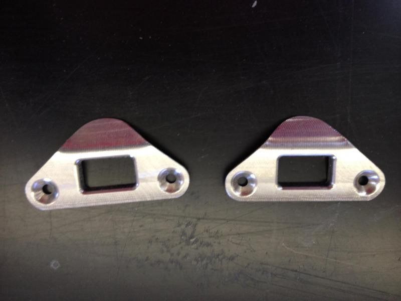

comparing a folding top to our version is not a fair comparison. while they both serve the same general purpose they are completely different. it would be like comparing a 2.2 to a 3.6 - yes they are both porsche engines and they both move 911s but that is where the similarities end. that being said purchasing a refurbished top from dan at cars inc runs in the $2600-3000 range (last i heard) for a point of reference. of course it would be cheaper to send him a top and have it refurbished but again that is not a fair comparison to our version as ours is the entire piece and we don't convert or refurb folding tops into what you see in this thread. add to that the fact that we not only have to make the top but have all the pieces made that are NLA like the plates (front and rear), guide pins, side seals, latches, etc etc and the difference becomes even greater.

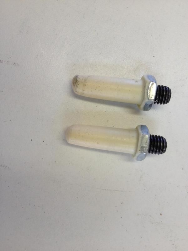

front guide pins are done

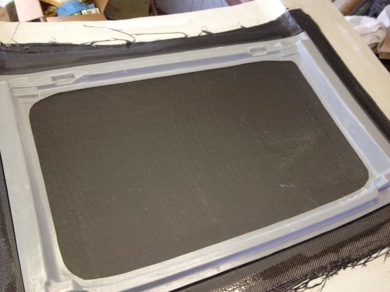

bottom being trimmed and fitted to the top
top skin removed from the mold

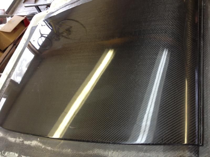

That is BEAUTIFUL! Does the top come out of the vacuum bag with that wonderful gloss / sheen or did you have to go thru a sanding / polishing process? Oh and the BIG question; are you guys getting ANY sleep? I hope so but I have my doubts. This thing is looking amazing and might make me think twice about painting my CF ducktail rear lid. Also, I have some kind of fiberglass (1 pc) targa top on my car. I guess I should weigh it for comparison sake.
Great job guys!
cd
82 911SCT
Old 04-17-2013, 04:23 AM
  Pelican Parts Catalog | Tech Articles | Promos & Specials    Reply With Quote #189 (permalink)
Join Date: Mar 2010
Location: metro detroit
Posts: 1,072
Thanks CD,
That pic is straight out of the tool. No sanding or clear coat work has been done yet. Sure does provide for a good starting point for post process work.

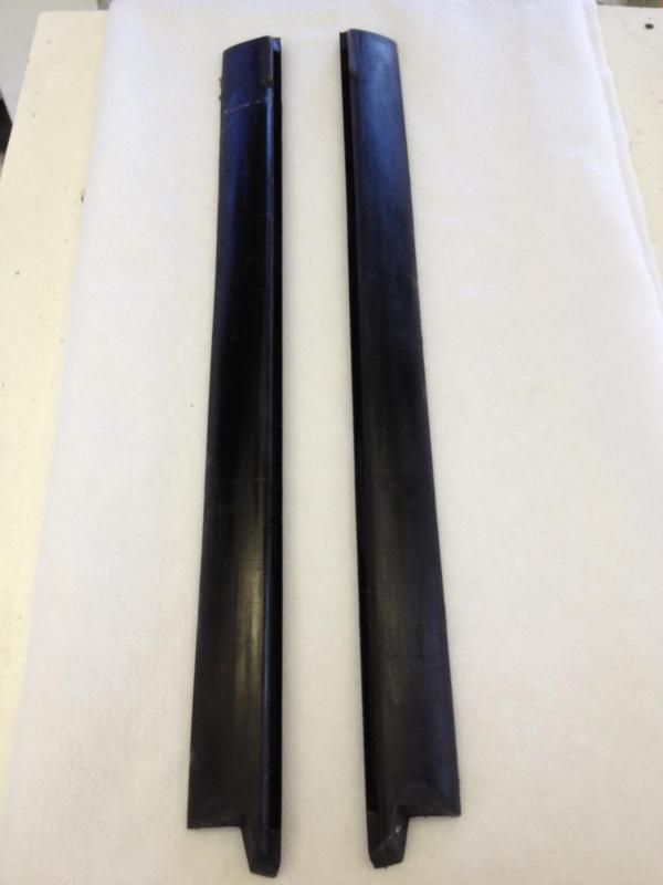

our new reproduction side seals and eustachian plates are here!

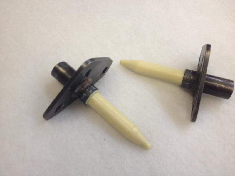

guide pins are done

What are the front and rear guide pins made out of? Are they just plastic covers over threaded studs? They look durable.
Old 04-17-2013, 07:53 PM
  Pelican Parts Catalog | Tech Articles | Promos & Specials    Reply With Quote #196 (permalink)
Join Date: Mar 2010
Posts: 1,072
front guide pins are a threaded stud covered in a high density urethane, the rear are made a little differently, it's a steel pin centered in a tube and that tube is filled with epoxy. The tube is tig welded to the mounting plate. The pin itself is covered in the same urethane.

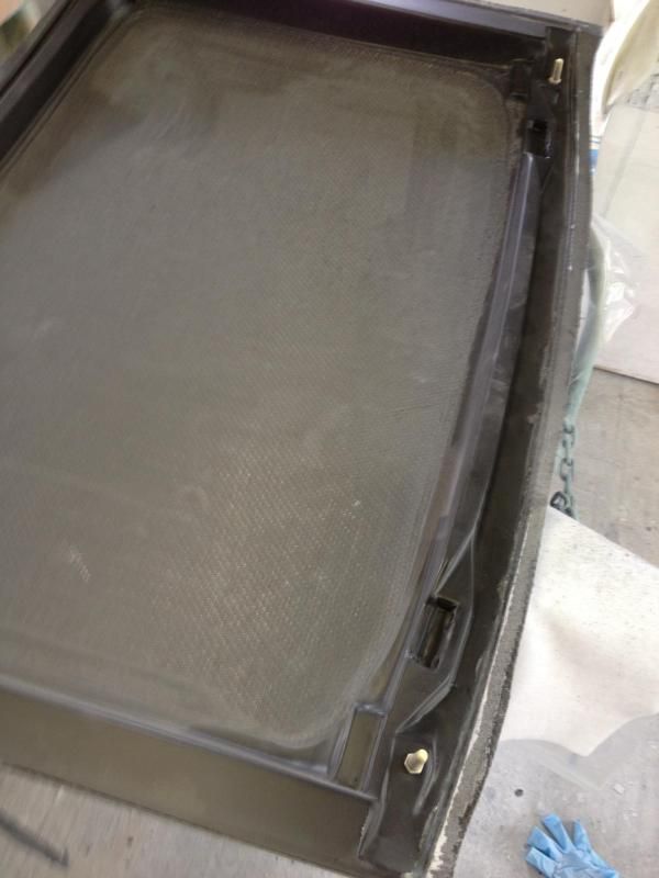

talk about coming right down to the wire....
bottom is bonded to the top and being trimmed as we speak
Now that is one hell of a job! It looks very OEM, well done guys! The parts you guys created have a solid look and just looking at the bottom here, everything looks very tight and professionally executed! I can't wait to see it installed!
