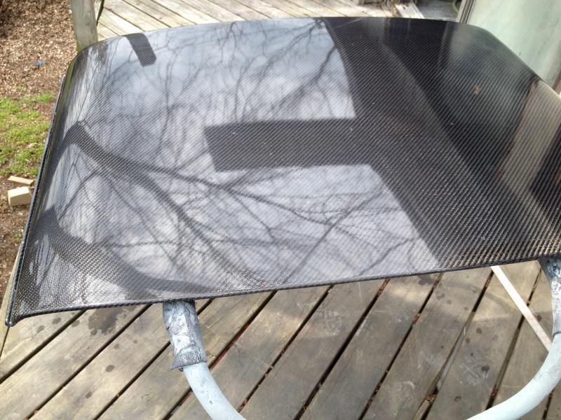

Mow that the top is trimmed, i've weighed it and the result is.......
Wait for it.......
10.5 lbs

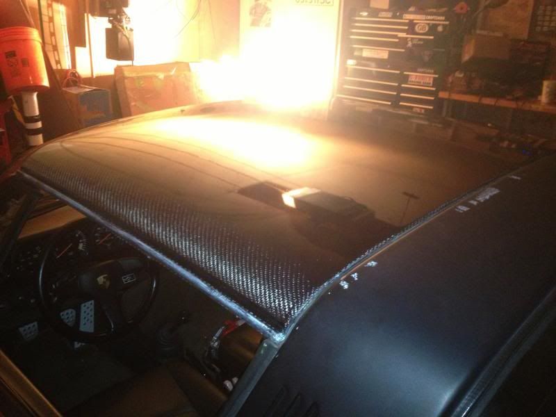

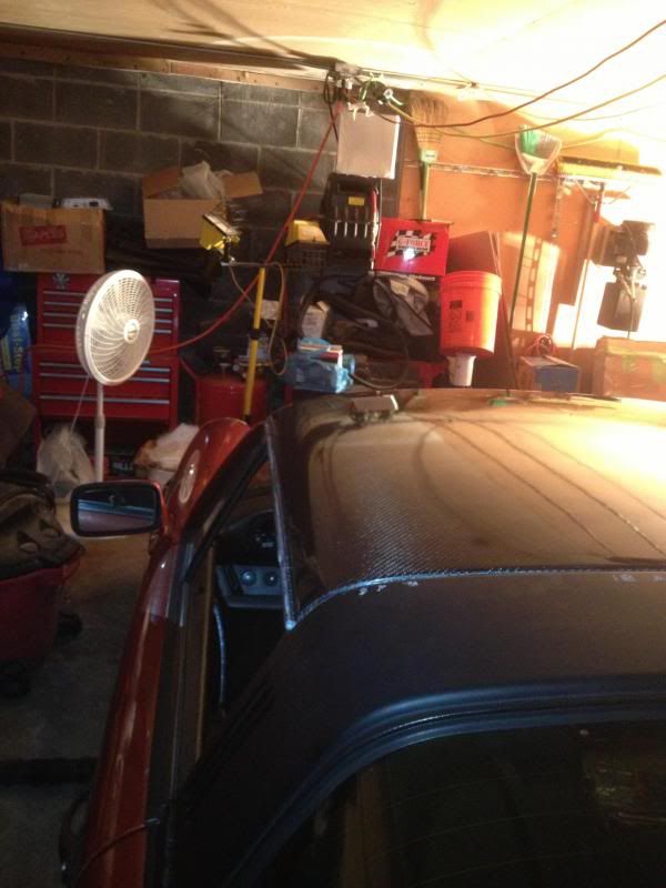

fully trimmed and bonded!!

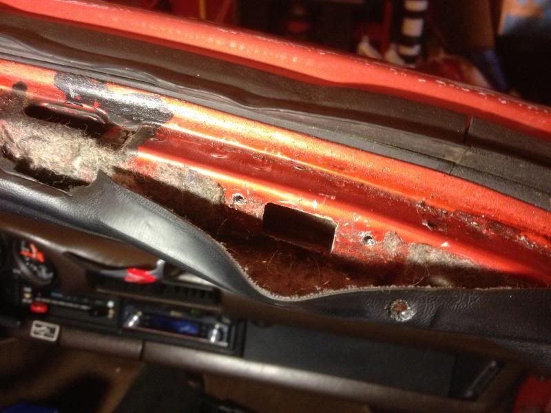

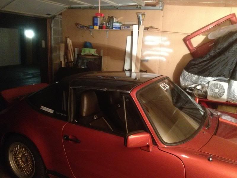

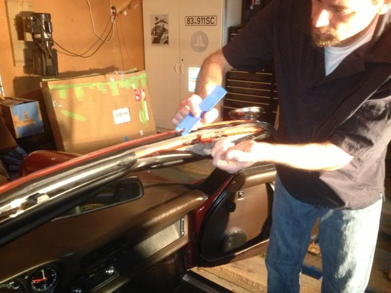

top fit great on our first test fit...
ran into a slight problem... my 83 does not have the cutout for the escutcheon which leads us to believe they may only have the cutouts up to 1977, which (i believe) was the last year of non-power brakes, which makes sense as you cannot fit the hardtop in with the master cylinder in the front. here is a shot of the front not pulled down into place.
tomorrow morning we will tackle the problem and cut the openings with my dremmel so that we can full mount the top.

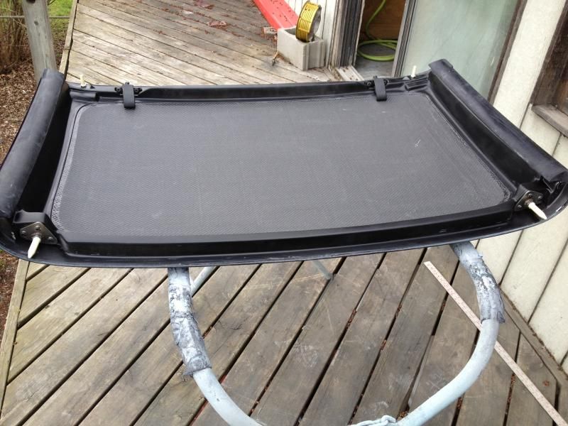

for the prototype we are actually using factory latches. the stamping tools for out latches are not quite done yet but we wanted to having a working prototype for hershey. we 3d modeled the factory latches and will be reproducing them.

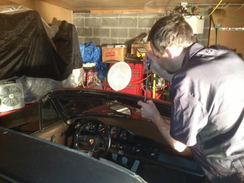

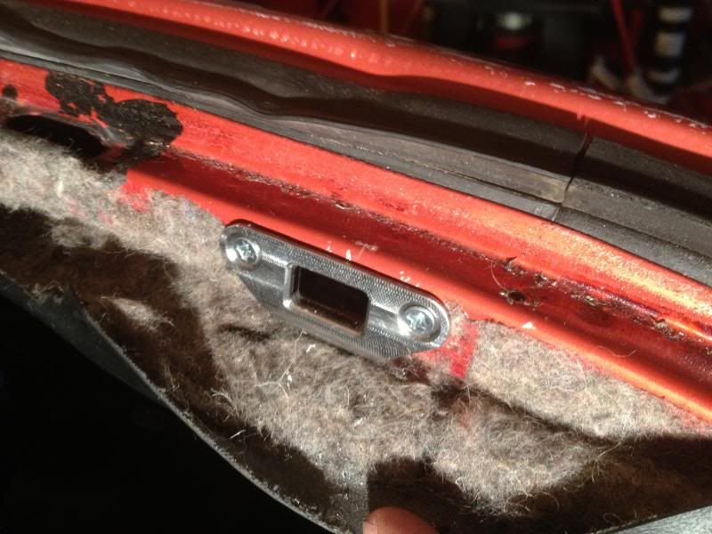

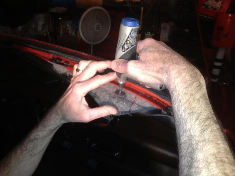

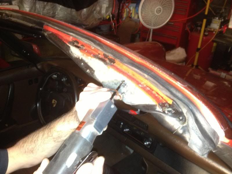

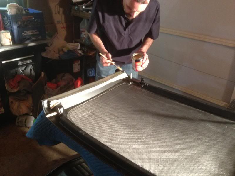

so here are shots of us making the openings for the escutcheon plates. it took a combination of drilling, a dremmel, an airsaw and a file or two but we got it.
removing the trim piece
partially removing the leather
various tools to get the opening we need
plate installed, trim back on

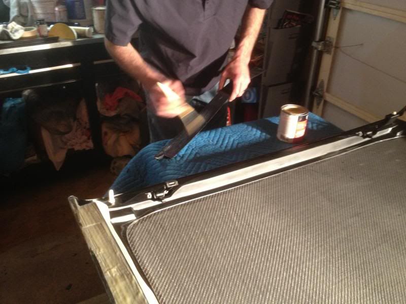

weldwood being applied to the seals and top
if all goes well we should be on the road within 2 hours and arriving in hershey around 10pm tonight. see you there!
