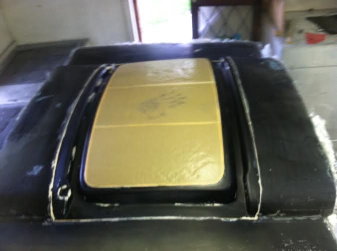

toddc 07-09-2013 03:28 AM
Progress has been slow due to other commitments however I'm still moving along on it.
The j-hook bottom is nearly completely modeled and I hop to be laying up the tool over the weekend.

toddc 12-02-2013 03:28 AM
Hi Dennis,
that factory hard top latch has been a major stumbling block for us.
It's something that we have been unsuccessful in finding and simply can't afford to have stamped.
We have decided to focus efforts on the j-hook version next and are making some small progress as we can.
If someone else out there can helps source factory hard top latches, we would love the help!
Thanks,

toddc 05-21-2014 03:43 PM
Won't be long now, bottom mold for the J hook version is being laid up right now!
Next is pull the proto, test fit on Nineball's car and go for production!
http://forums.pelicanparts.com/uploa...1400715732.jpg

toddc 06-21-2014 06:51 AM
up!
proto top skin in natural amber fiberglass and proto J-hook bottom frame complete and ready for test fit, fixing on a model......
I'll post up some pics later today/tomorrow after primer dries.

toddc 06-24-2014 10:37 AM
The long awaited J-Hook bottom frame is now finished. I'm moving into the test fitment phase now and am looking for a couple different vehicles to verify fitment on.http://forums.pelicanparts.com/uploa...1403635051.jpg
