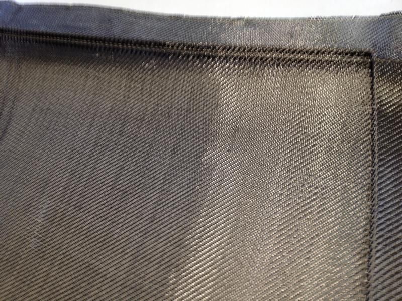

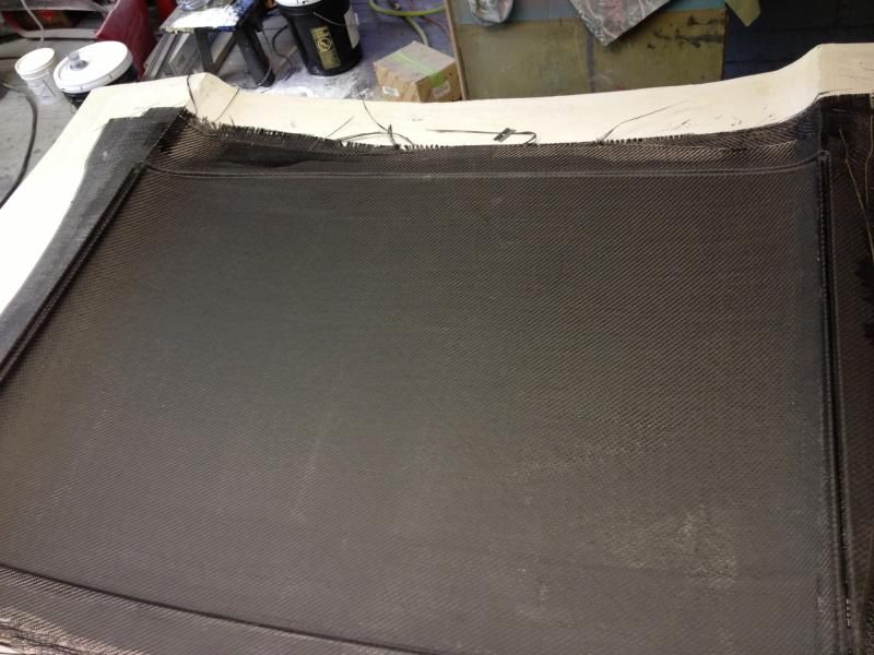

nineball 04-15-2013 11:06 AM
here is a shot of the dry fabric tacked into the clear gelcoated tool getting ready for infusing. it shows how tight we have to have it to the mold surface in critical areas like the rain gutters and edges.

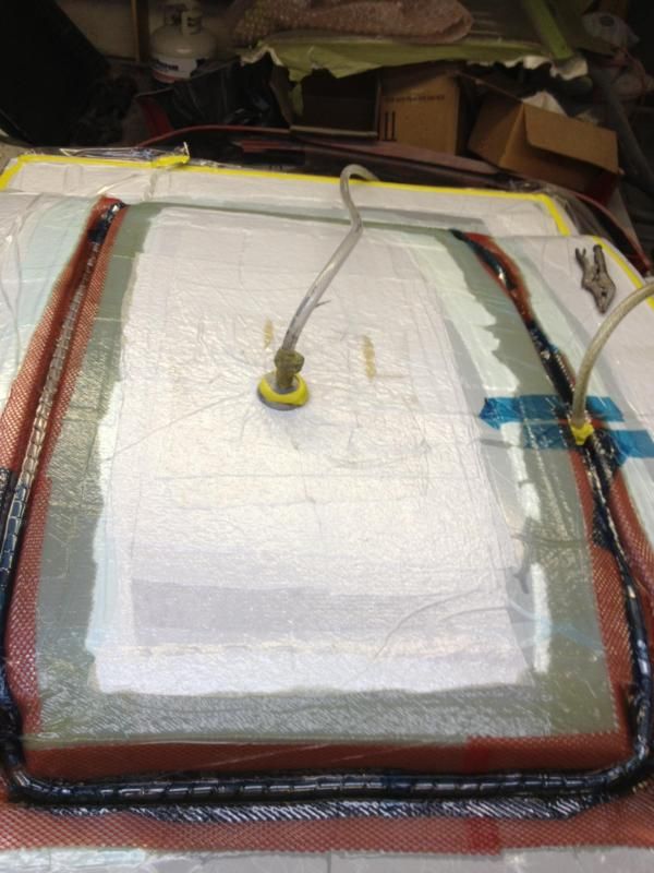

nineball 04-15-2013 12:31 PM
i will once we get back from hershey. since it's approximately 6 hours each way i should have a good opinion. that being said i know my seals are 30 years old and i plan on buying a new front seal from dan at hershey, so my results may not be typical.
getting ready for the infusion....
http://i15.photobucket.com/albums/a3.../IMG_0488.jpeg
nineball 04-15-2013 04:13 PM
bagged and curing
http://i15.photobucket.com/albums/a3.../IMG_0490.jpeg
bagged removed after infusion. those are some sexy lines todd has created
http://i15.photobucket.com/albums/a3.../IMG_0491.jpeg

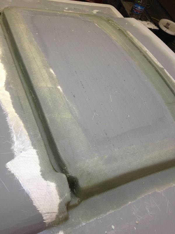

nineball 04-15-2013 06:39 PM
bottom is bagged
http://i15.photobucket.com/albums/a3.../IMG_0493.jpeg
and the bag is removed
http://i15.photobucket.com/albums/a3.../IMG_0495.jpeg
so we have both halves of our prototype sitting in their molds and soon they will be trimmed and bonded.

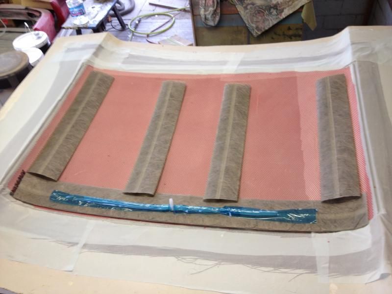

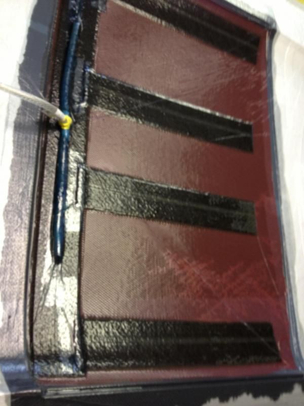

Karaya 04-15-2013 09:06 PM
Hi Nineball,
I been watching your work on this thread and it's very excellent.
My question is in one photo where you have what looks like 4 longitudinal 2-3 inch wide carbon strips...that's there for reinforcement of the outer skin, correct?
toddc 04-16-2013 03:09 AM
Karava,
no, those strips are my resin distribution lines. As you see in the following picture, they get removed after the resin is drawn completely through the skin.
The top skin doesn't need any additional support due to it's laminate structure.
Karaya 04-16-2013 06:07 AM
Originally Posted by toddc (Post 7388743)
Karava,
Ok I get it...The black stuff is like some fluffy material that lets the resin through...correct?
toddc 04-16-2013 07:00 AM
K, sort of. It's a semi rigid very porous material that allows resin to flow quickly.

toddc 04-16-2013 07:59 AM
Thanks for the compliment Charles,
What I like about the infusion process is that we can tack all the laminate in dry, then suck it down tight to the tool ensuring no voids or bridging, then use that vacuum to pull the resin through the fabric. Very slick and a lot less messy than typical open layup/bagging.
