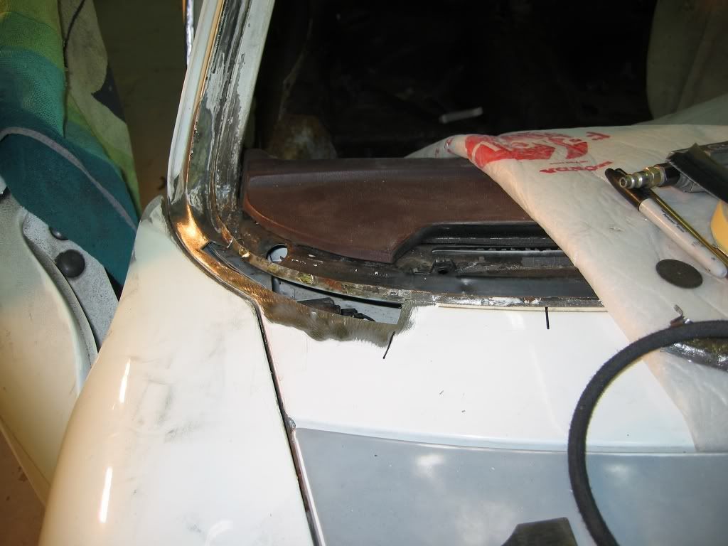

Seymore, this is my experience...
The front was worse and the suspension was not stable. I had the car stored for several years so it just kept rusting. I am in Ohio where salt is the main stay of citywork crews so rust is constant if you drive in winter.

Wow thats a little larger than mine. It looks like it turned out beautiful. You do good work. Im not that skilled. Im hopping I can just use my drimel, a little body filler and some touch up paint.

Your's is an 82. DG624 does not post his car year. His could be a 74. They melt if you throw salted popcorn on them.

I didn't do the work...done by a local body shop Yoke's body shop. They are very good and reasonable prices. I have an 86 that was driven in the salt.

Wow. Shut my mouth right up. Hopefully seymore's car has been based in the DC area. I still don't think he has major cancer.
