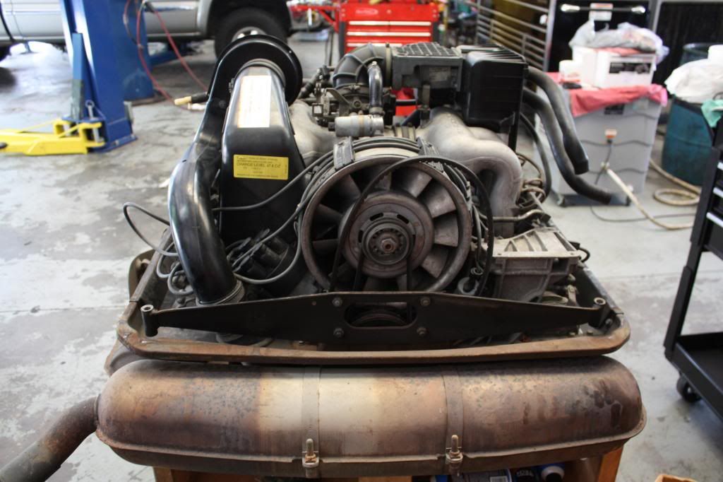

The mandatory 1st time engine drop photo.

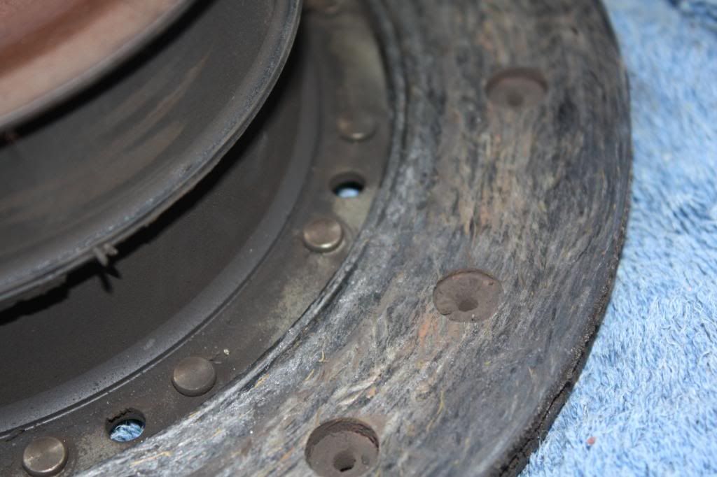

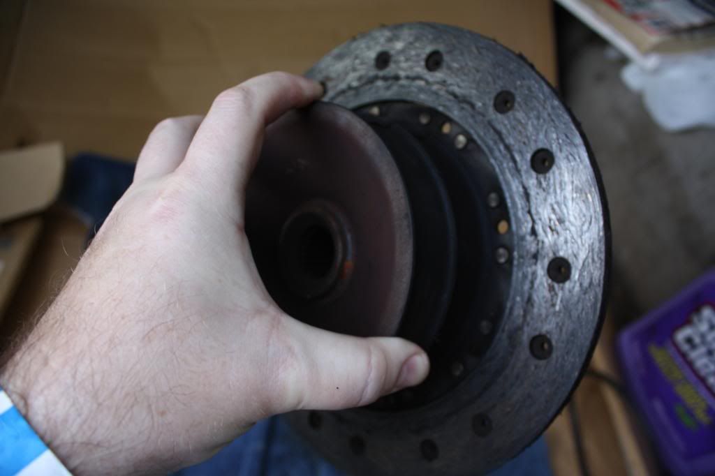

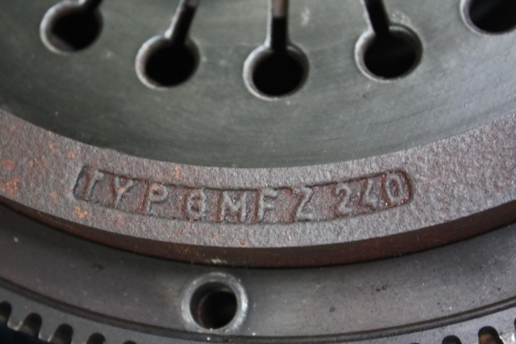

This one shows how close I was to touching the rivet, and the state of the rubber hub, and what makes me thing I should be able to use the pressure plate and flywheel after they are resurfaced?????

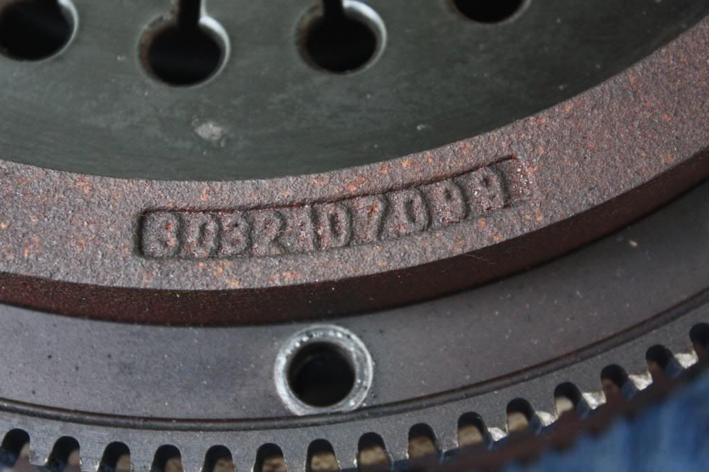

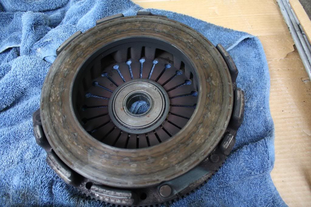

The surface of both the flywheel and pressure plate now looks way worse than it did when I first took it apart. Not sure if I should preserve it with oil or something prior to having it resurfaced? Also, shows the model number of what I have. Not all that sure why it has writing on it?
HOW DOES THIS LOOK?

The writing on the flywheel looks like it's been resurfaced ten thousandths.

Not sure you can resurface a G50 flywheel without causing some ill effects ... better look into that before you consider it.

Don't sweat resurfacing your flywheel. It can be done as long as it's a proper double cut that cuts the contact surface and the pressure plate mounting surface (note how the flywheel is stepped). The stigma that's been attached to G50 flywheels is because of the rubber clutch disc. If you were to cut the flywheel, that brings the clutch housing closer to the top of the considerably tall rubber damper on the disc. But if you use a spring disc, it becomes a non-issue because the spring disc has nowhere near the damper height of the rubber monster.
By the looks of the pressure plate and flywheel contact surface, the clutch has seen a decent amount of slippage & heat. Still should be able to clean it up no problem. Could also resurface the clutch contact surface if desired. Just a teeny amount is all it needs to clean up the surface for a new disc to grab on.
The clutch is dated 1993 so it's pretty old. But these Sachs clutches are near bulletproof. I wouldn't hesitate to reuse one. Just be sure to take a look at the drive straps around the periphery of the clutch. Those transmit alot of load and can crack where riveted to the clutch housing and contact foot/disc. They usually crack from people doing too many 1st gear hard launches- like side-stepping the clutch from a dead stop.
That clutch disc you had wasn't worn as bad as you think. The rivet depth is quite shallow on a new disc.

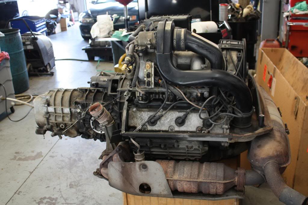

Does anyone have a photo of the G50 trans? One photo I did not take was the one side I took two brackets off and am not sure of the orientation. Also while cleaning I noticed a place for a sensor that I do no recall ever removing. The hole is near the CV joint coupling. What it has is a hole and an adjacent screw hole. I'm rather confused by this because to my knowledge neither I nor the guy helping me removed anything from this spot. I can take a photo for ref if needed.

The photo above of the side of the engine I can tell how the one bracket goes
with the white looking plug. BUT, because the heater hose in in place I am
unable to see what would go in the described hole.
What has me worried is this could have been open for a very long time and I
may should flush out the inside of the trans. I do have access to a trans flush
machine. It is however for automatic trans. but I should be able to use our type
of oil rather than auto trans fluid.

Can you send a pic of the hole you're describing? There's a hole adjacent to the CV flange for the speedo sensor, but in the pic it looks like the sensor is in place.
If you browse posts for engine drops you find lots of pictures of dropped drive-trains that you can use for comparison.
