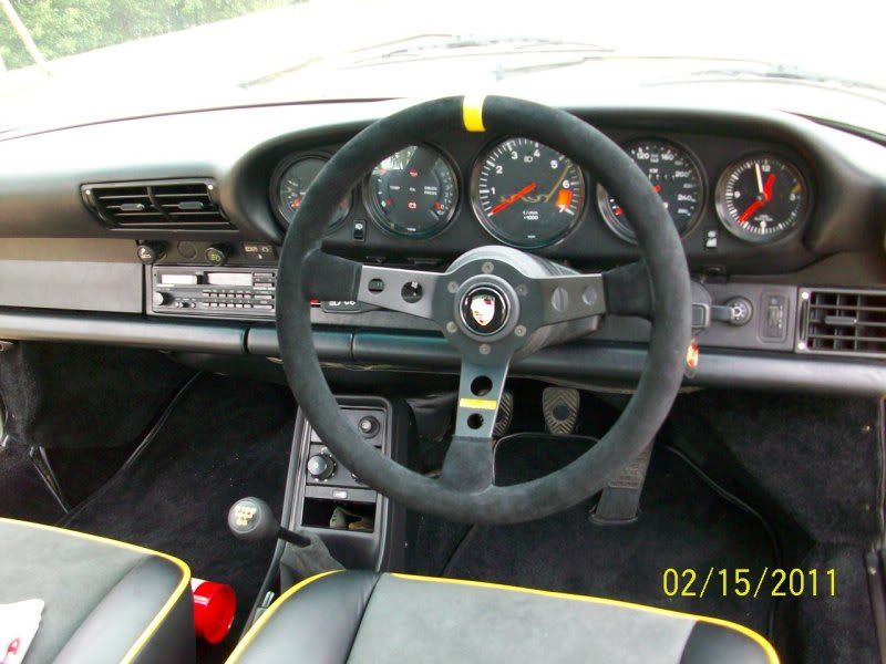

How to fit a 915 rubber boot into G50 center console

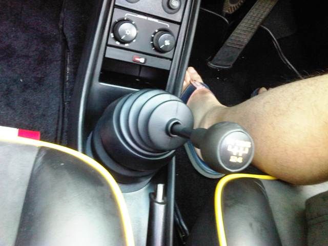

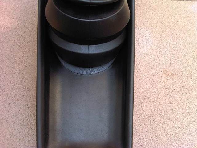

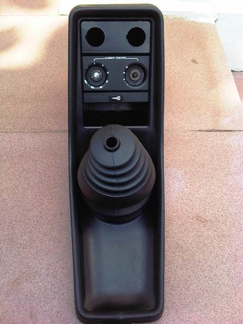

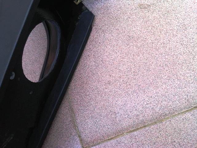

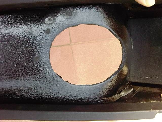

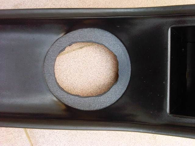

Hello,
Here's how to fit a 915 rubber boot into a G50 center console. G50 center console hole diameter is bigger than that of 915 boot thus boot will become loose & come out of the hole when you shift thus making it unsightly.
The solution is to add a layer of leather / vinyl / foam to hold the rubber boot base from coming off of the hole of center console.
Stuffs needed:
1. Sheet of leather / vinyl / foam ( I use foam)
2. Glue.
3. Scissor.
Steps:
1. Cut a hole on the foam the size of boot diameter.
2. Glue the edge of the foam onto the console from the inside.
3. Slide the boot through the foam.
Before
After (pardon my hairy leg)

Interesting. How do you like it?
BTW, please delete the double post.
