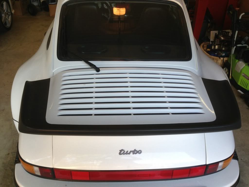

Is this a orginal 930 wing or some kind of aftermarket bolt on?

But whether it's a genuine Porsche wing, or a copy is hard to tell. Certainly, there does not appear to be enough nuts/bolts securing it to the engine cover, and there also should be a couple of drain holes to let water out.

That is an early deck lid, and the pictures of the wing aren't good enough to tell if it is a factory part of not.

I don't know what it is, but I can tell you it is not an early 930 wing (totally different shape, etc) and it is not a later 930 wing as it is not designed to accept an intercooler and the later ones did not use a rear wiper setup like the one in your picture.

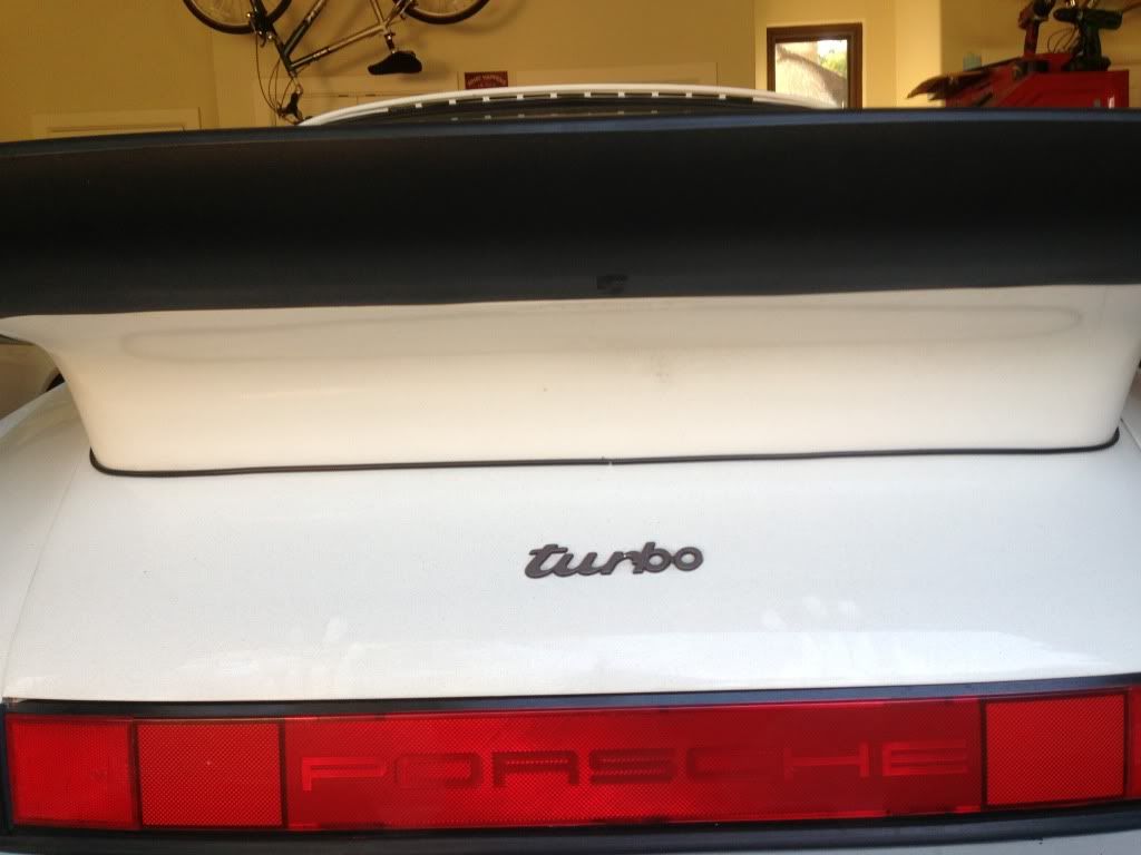

My car has that exact same set up. It is a 75 that was converted to widebody with panels from an 86. My deck lid is a non-turbo like yours. My tail is an original Porsche tail with the wiper like yours. Look at the back, middle of the wing below the rubber lip, but above the deck lid. If you see a Porsche emblem molded into the base of the tail, it is an original Porsche part. Here's a couple pics:
Look right above the turbo emblem:
"Too much is just enough."

The wing is the 930 style, it is the decklid that is an early lid (the 930 lid is cut to allow the intercooler/

Thanks alot i found the emblem, sry about the crappy pics i used my phone.

Cool in that case its prob the original lid from -72 under there so i can just bolt of the wing and source a grill for it.

Unfortunately to install the wing, holes were drilled in the decklid that will need to be filled, finished, and painted.

Yes sir, and have the holes filled you will be good to go..
