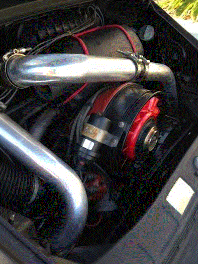

Hello! This is my first real post so bear with me. I have a 1981 911 SC. I found out early this morning that it had a major cold start issue. I warmed it up for a few minutes but as I went to shift and give it gas it would sputter and die like the gas pedal was not being pushed. The PO says he was setting the car up for autocross and disconnected the choke? I am not sure that makes sense but am here to learn. The fuel injectors also need to be cleaned or replaced. This car was a gift from the owner for a real estate deal I did not take a commission on. He showed up and dropped it off to me so no pre sale inspection. I am going to check the forum now but would appreciate anyone pointing me in the rite direction. Looking forward to meeting everyone and learning this car!

There is no choke on an 81. There are throttle air bypass components. Can you take your cell phone and shoot a pic of the right side of the engine - take a pic or two of the plumbing and hoses and such on that right side. "Go Advanced" and figure out how to upload these pics after you send them to your e-mail and save them on your computer.
One thing at a time. You also may have odd fuel pressures and you will be urged to buy a set of pressure gauges. You will need them if you are interested in maintaining the car. Vacuum leaks are also a big issue with CIS.
Also, try idling the car for 20 minutes and see what happens.

Bob- PO said that the shop he had taken it to recommended replacing the fuel injectors. I will take pictures in the morning and upload all. After 20 minutes the car idles nicely. It lacks the power I have felt in others cars I have driven at higher RPM. You can put the pedal to the floor and just get a slow steady acceleration. When you step on it you just don't get much of a response. Do you recommend any brand of gauges?

red fan car in SoCal...did your car have a Motor Meister rebuild by chance? you may want to give it back (just kidding). the cold start system is fairly complicated...google Jim CIS primer and read up. if you can hear a buzzing when car is running (coming from behind the air intake housing) it means the frequency valve is working (part of the system with the 02 relay - if you can unplug that relay with no change the relay is probably bad).

Last picture.......
Mike,
In the last picture, is that Swage fitting set-up for the hydraulic chain tensioner? At first glance, I thought the engine was a 'turbo' with the solid heating tubes. Was the previous owner a plumber? Just kidding. Welcome to the club.
Tony
