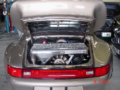

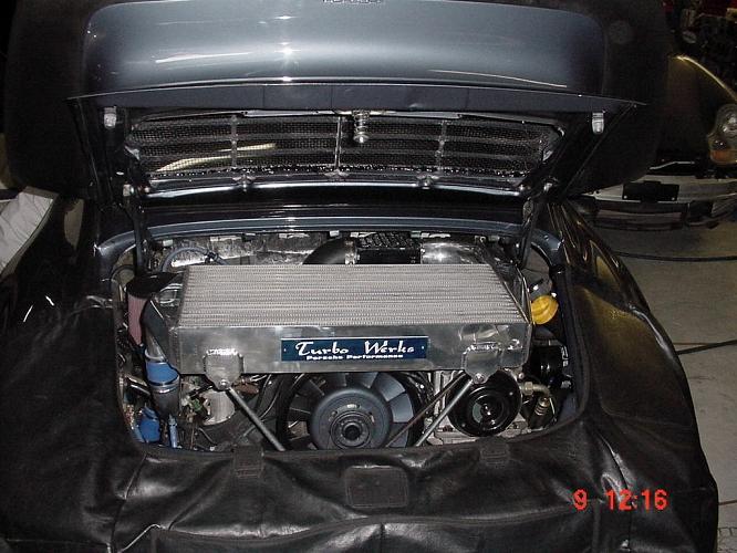

I find it will be a EXTREMELY DIFFICULT TASK,I have never seen anything like that,all your connections MUST be very secure to have a good flow and no leaks,Sorry on this one but no help,here is a few pictures of different set ups but all sit inside

You still HAVE to secure it to the motor, otherwise it will pop off.Just look at the other installations pictured here and you see how much bracing they take- it isn't just to support the cooler, it is to hold it down and tight!
I understand your space problem, but you need to find a way to make your's removable without a lot of hassle
