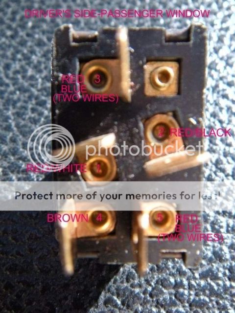

Ok guys, I have a dilemma. It was beautiful today, 68 degrees and sunny. I decided to take the Targa to pick up my daughter from cheer practice. Windows down and cruising. Problem comes when I go to put the windows up. Driver window goes up no problem, passenger will not go up with either the driver door switch or the passenger door switch. The switch on the driver door has been a little sticky so I had on on hand that I hadn't changed out yet. Changed the switch and still nothing. Any ideas?

I feel there is no power getting to the window motor. I hear nothing when either the passenger switch on drivers door or the switch on the passenger door.

Passenger window switch on drivers door is brand new today. switch on passenger door connections look fine. I do not have my meter at home here so cannot check voltage. Which wires do I need to test on the back of the switch to check for 12 volts?

keep in mind that the passenger door switch is tied to the drivers door switch for the passenger window.
I grabbed a 12V battery and pulled the wires for the motor off the switch and plugged them into the battery..Window went up! turner out to be the drivers side switch for the passenger window...go figure Thanks Don! experience is sometimes the best teacher.

Yup. Check the driver's side switch if the passenger one doesn't get voltage. You can pretty much use a test light with one end on ground.

Ok, here is what I found. If I test across the two bottom wires in the above photo I have 12 volts on all three switches with the key in the on position. I assume this points to a bad window motor.
Any other thoughts?

I had the same problem on my 87' 911. Pull the motor out, disassemble it from the gear drive. Give the worm gear a couple of turns by wrapping a rag around the gear and carefully use a pliers to turn it. Hook it up to 12vdc and see if it spins. If so, then your armature is cruddy. Pull the motor apart, carefully clean the armature with some thinner followed by running 600 grit paper gently around the armature. Slap it back together and your home free. If it doesn't run when hooked up to 12vdc following your manually turning the gear you motor is dead. Just be carful when taking it apart and re-assembling so you don't damage the brushes.
