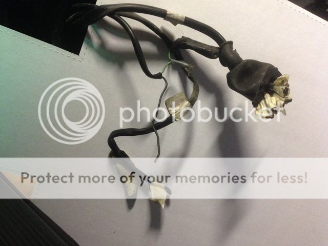

Ok, so I had a power window (passenger side) go down normal but not go back up. I replaced the switch and no different. Replaced the motor and still no different. Goes down but not back up. I pulled all apart again and pulled the wires to look and I find a wire not attached to anything. Can someone look at the picture and tell me where it goes? And if this is my problem with the window not going up? Thanks. Joe
Bottom wires are to the motor and top cluster is to the switch. middle group has two wires going into a connector and one wire by itself.
