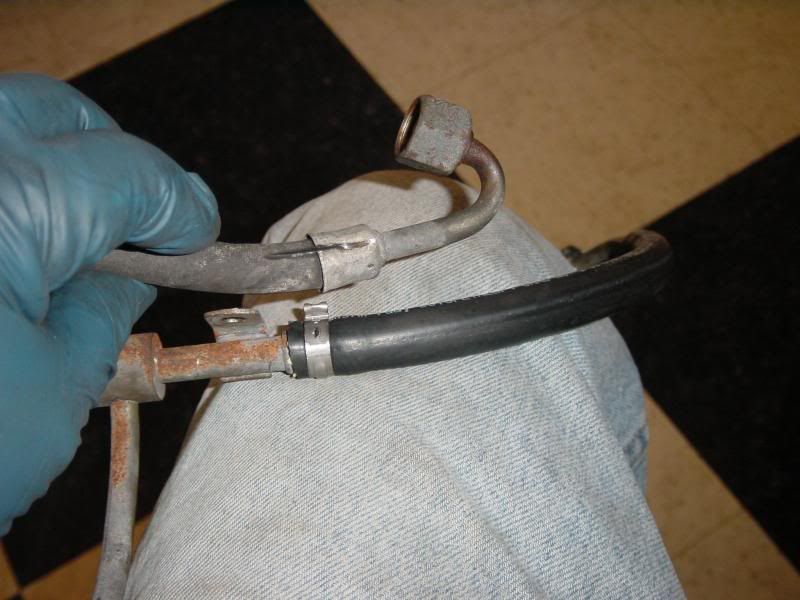

You will need to get that cross shaft out to inspect the RMS and make sure it's not a leaker. You could try with a needle nose vice grip to grab and pull now that the bearing is out. That looks like the factory upgraded shaft and if it is, someone has been in there before. You can also drill a hole and run a tap in to cut threads and pull or maybe just a big sheet metal screw would provide enough grip to get it out. Maybe if the drill but jams it would allow enough grip.
Fuel lines: The local hose shop will probably use a hose ferrule or collar which is too long. It will crimp down on the ridge on the pipe and cause a failure in a short time. I used Oetiker clamps when I rebuilt mine. Just get the proper type of line from the local auto parts store and crimp up your own. Works a treat.
http://i70.photobucket.com/albums/i1...ps427f94f3.jpg
Or Len on here BoxterGT maybe is his screen name, makes them up for you.

COLB 02-18-2014 05:21 AM
Jcslocum,
The hose shop was a bust. My first step is to go through BoxsterGT. Don't know what his backlog looks like, though.
Did you cut those fittings off with a dremel, and then clamp on new hose with the Oetiker clamps? How "fool proof" is that? I'm not afraid to experiment, but dicing with the fuel hoses makes me nervous. The cost of failure seems inordinate.
kidrock 02-18-2014 05:58 AM
do *not* take a chance with those fuel lines, you are risking an almost certain engine fire by doing so.
Len (BoxsterGT) will respond, be patient. He is a pleasure to work with and his product is quality.
