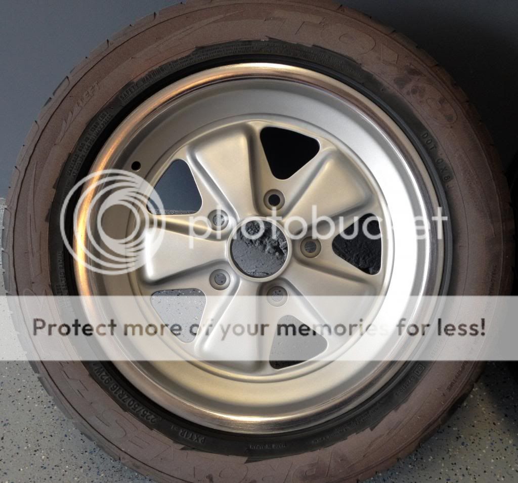

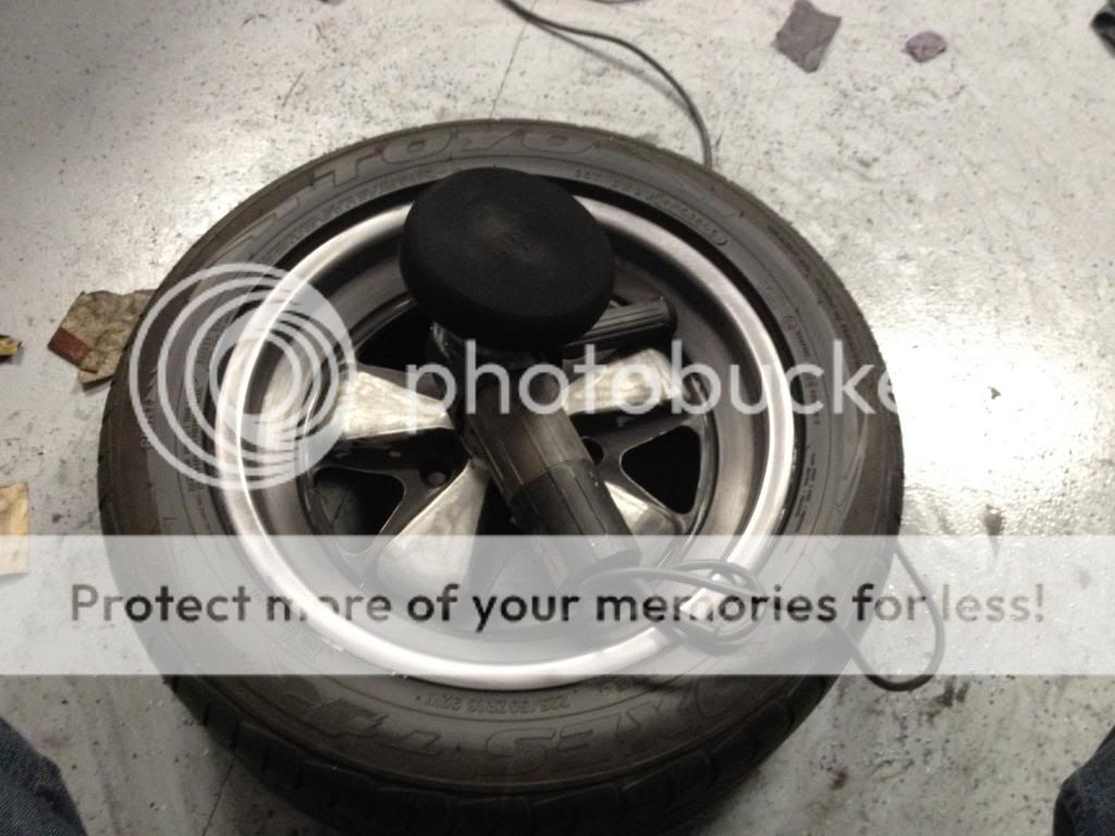

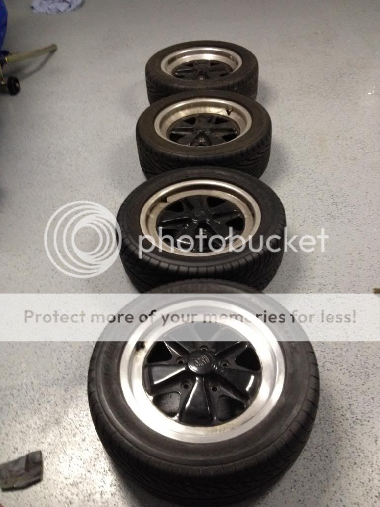

Happy holidays! I'm just wrapping up my Fuchs wheel re-finish project. I currently have 993 cup wheels on the car with summer tires; but given I'm now driving this car as my daily driver (including cold temps and some light snow), at a minimum, some proper all-seasons were due.
I got some old Fuchs that were in rough shape (to say the least!). I'm pretty sure some of them are not OEM (i.e. at least two I'm sure are replicas). Nevertheless, I set out for my first wheel refinish project. My original plan was to replicate the RSR style of finish with the black background... but that proved to have numerous issues in my DIY approach. The result is I went with a silver inside with a matte clearcoat and a polished outer rim/lip.
Disclaimer - I'm just a noobie that learned as I went along. I was hell bent on doing the end to end process myself. In hindsight, I would highly recommend sending the wheels out to get cleaned up / stripped, as it would make your DIY part of the process a helluva lot easier! Also, if you are a diehard perfectionist just send them out to a pro IMO.

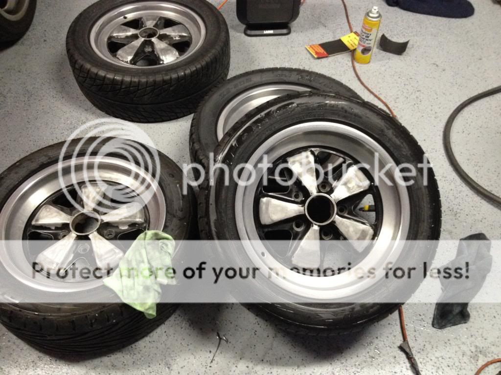

Here are some pictures from beginning to end over two weeks I spent working on these.

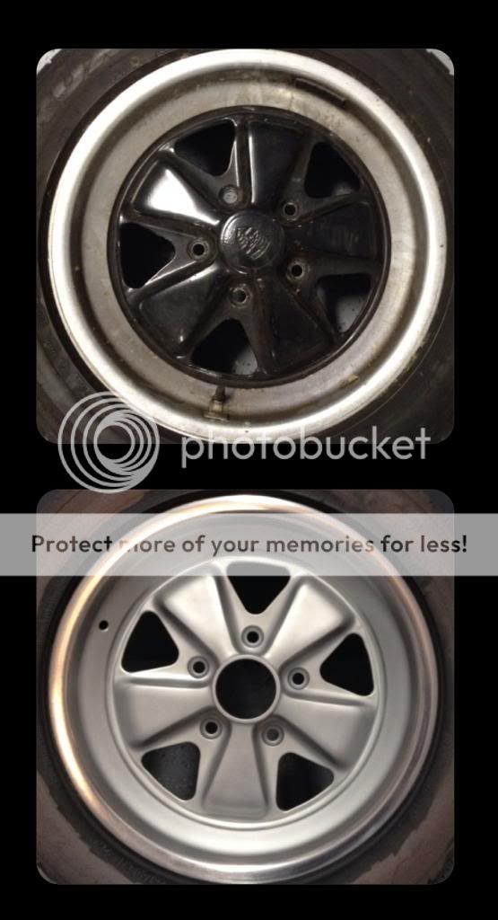

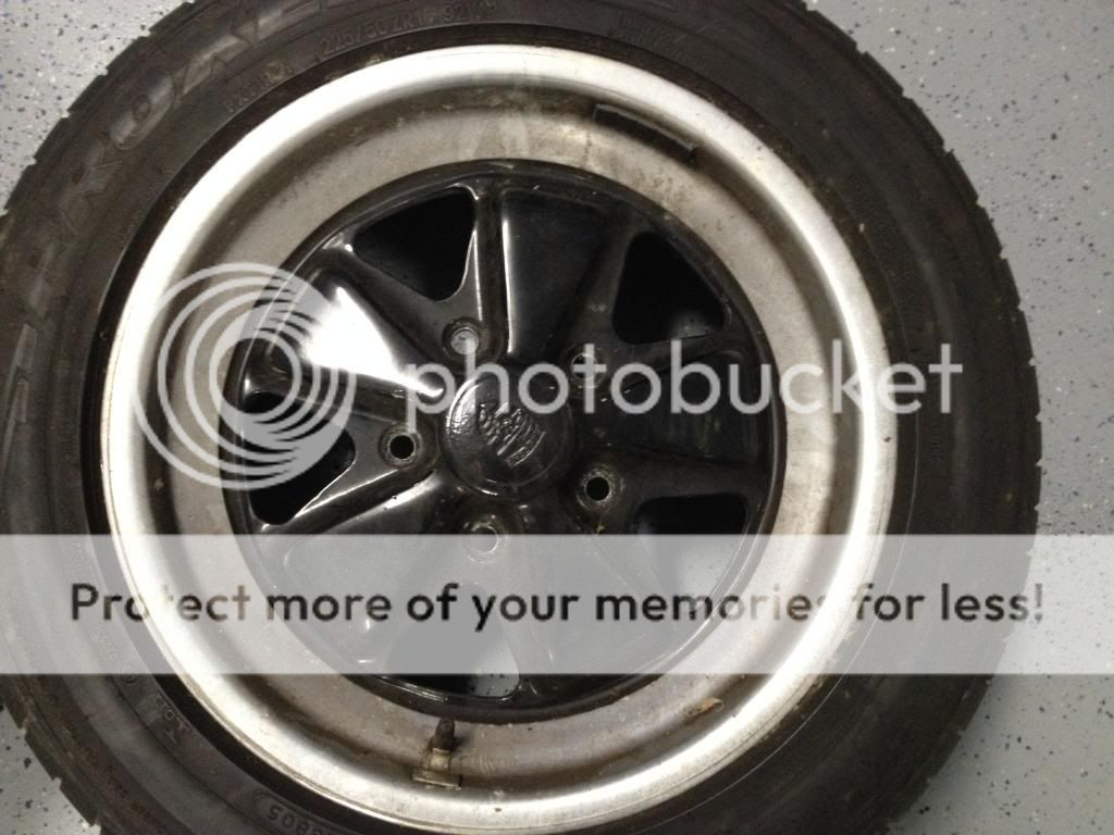

Upfront before and after:

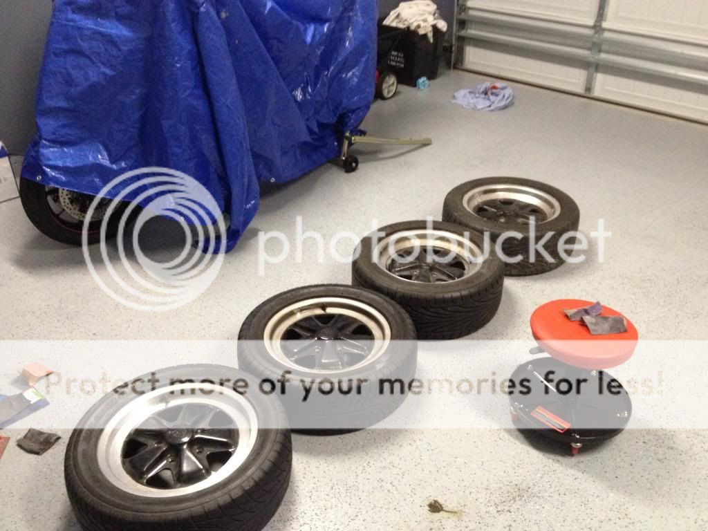

Starting out
After lots of sanding/cleaning etc. Used orbital with metal polish for final lip polishing after my hand sanding.

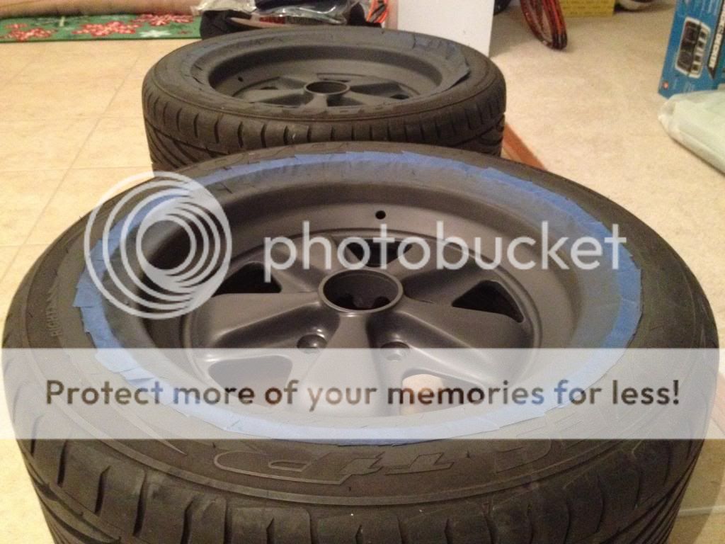

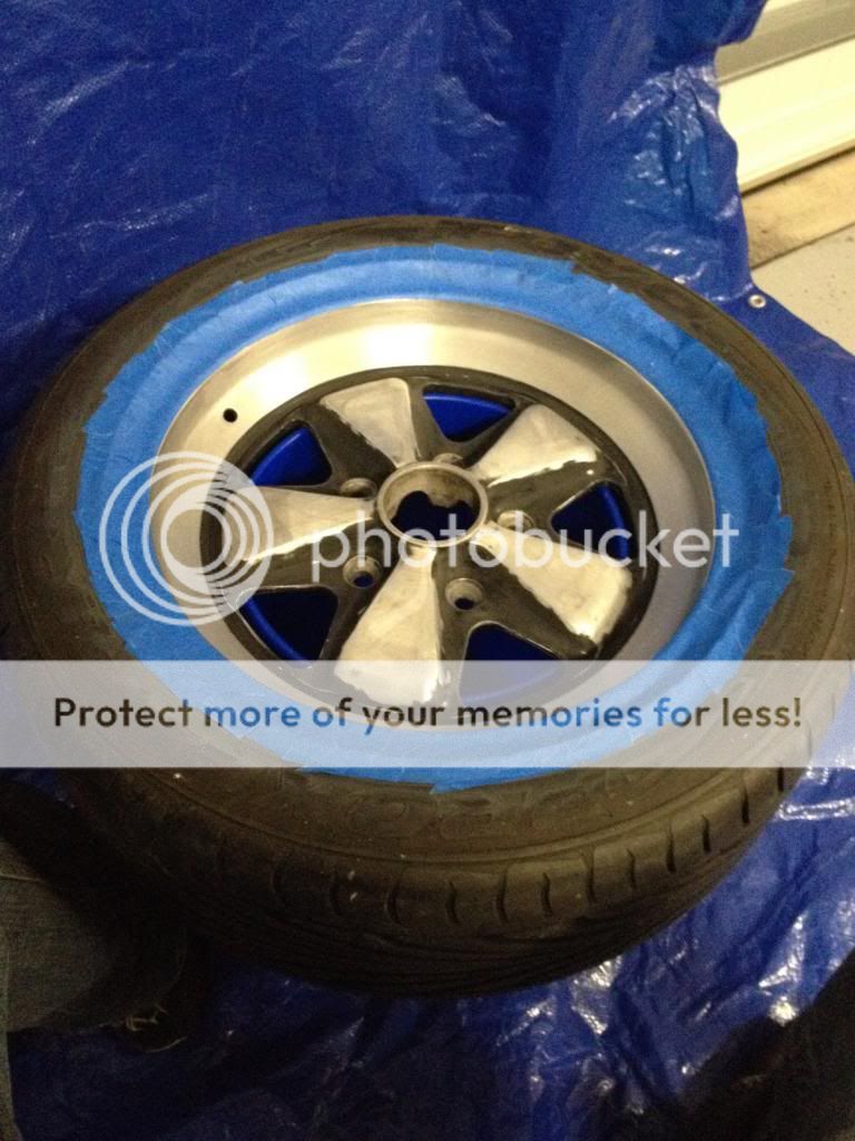

Masking (2nd worst part aside from sanding)

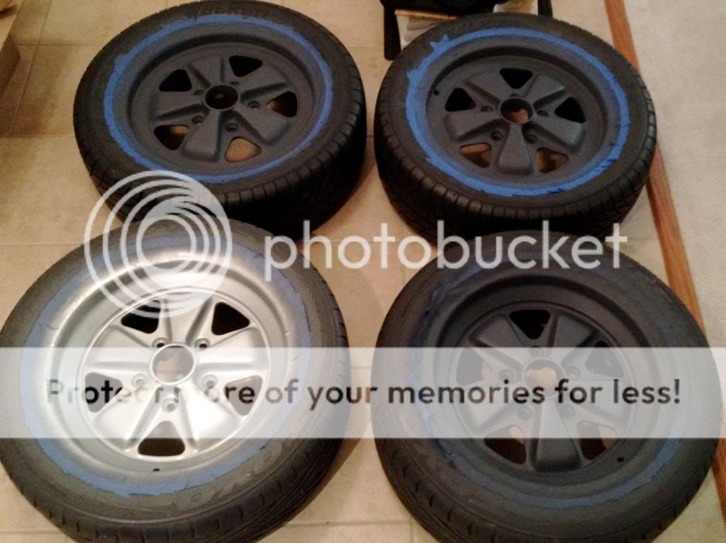

Primed and inside drying in the warmth
My simple painting setup

Join Date: Aug 2010
Posts: 288

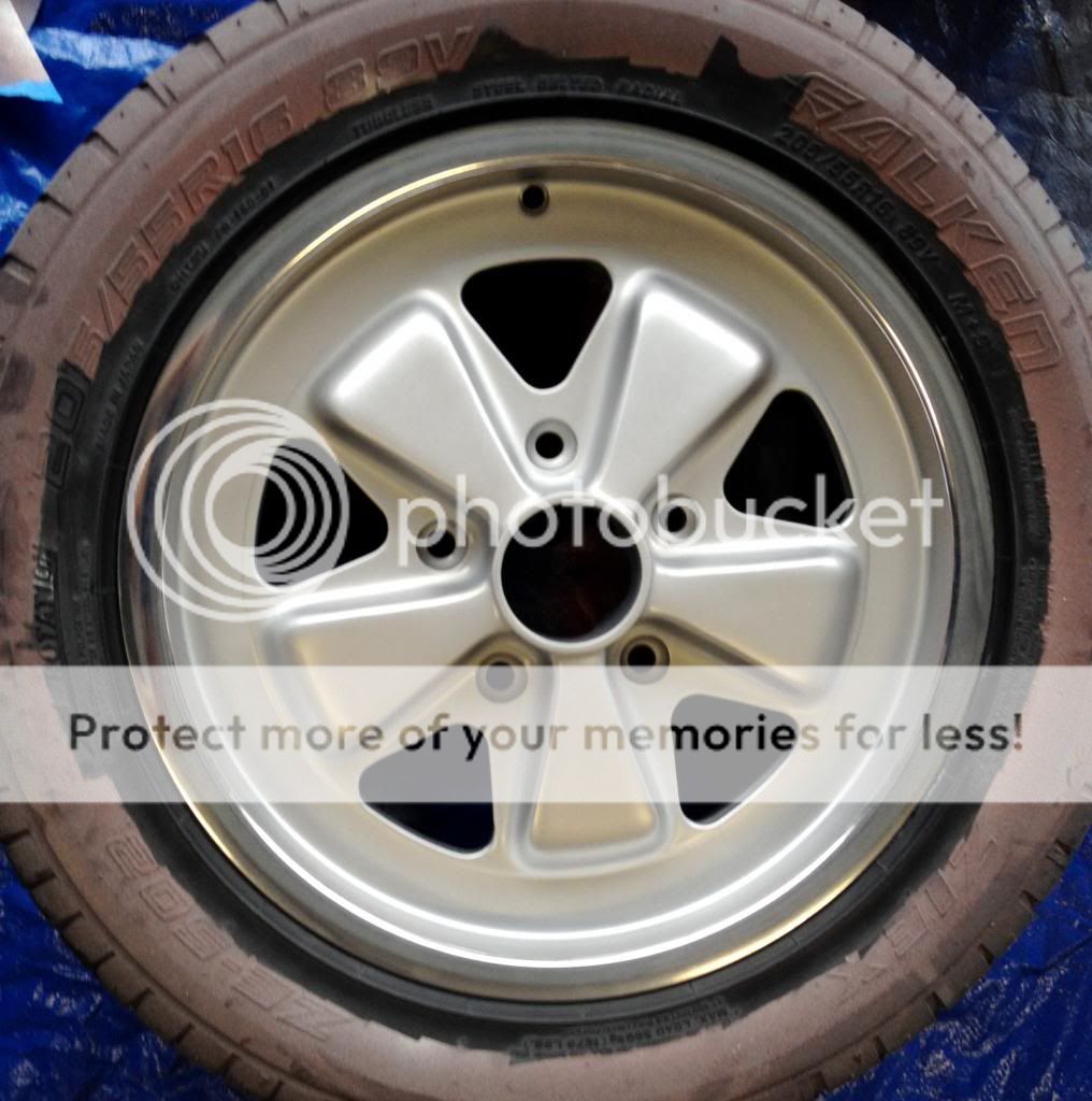

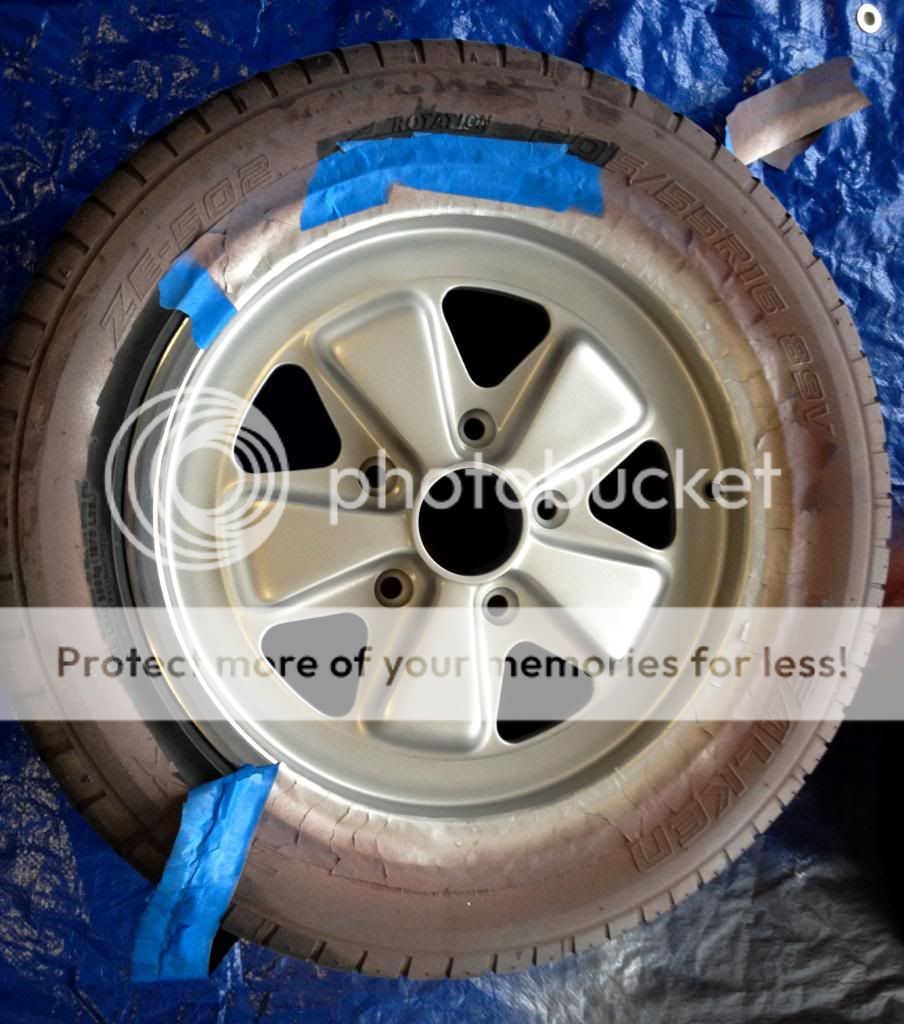

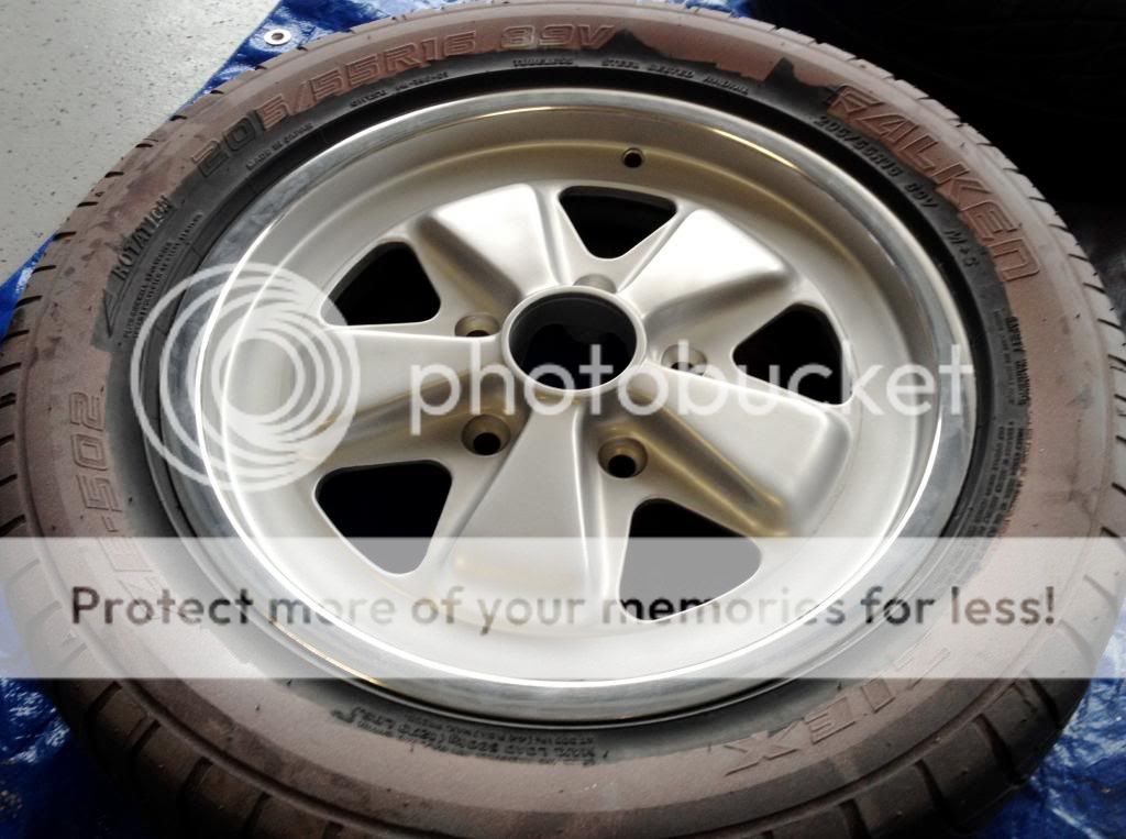

Silver final coat vs. primer
Holding breath as removing masking from polished lip. This shot is as the final matte clearcoat is drying
Finished product

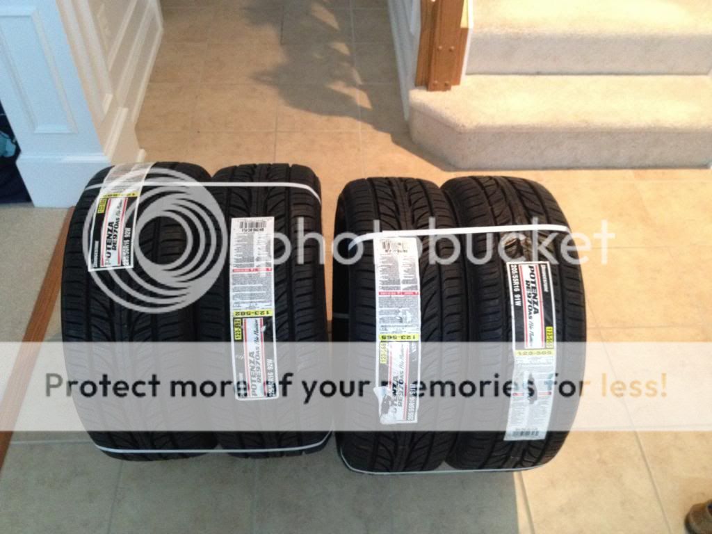

Tires arrived
What problems did you encounter on the black background? When I re-painted mine I didn't find that to be terribly difficult.

Arne - How did you mask off for the RSR finish? Looks like you went the polished route (i.e. the spokes of your set is polish vs. painted). I had issues with the silver metallic paint not liking my masking - perhaps I didn't let it cure enough before starting to mask over the silver paint, but the first wheel I did ended in tears, as the blue painters tape pulled up the silver metallic. In the end, I think I almost prefer this different look for now. thanks
RSBob - Thanks!
Elom - I used all duplicolor products. After (what felt like) years of sanding and then polishing the outer lip, I used a base primer and a filler primer when needed - sanding in between primer coats. Then I used the silver metallic from duplicolor (2 light coats, follow by one medium coat). At first I was not sure the silver metallic was the right finish for me (a lot of pop and metallic fleck). Then I did 3 light coats of the duplicolor matte clearcoat and it just make the wheel exactly how I wanted them. It's hard to tell the difference in pictures but the matte clearcoat is a must to get that really flat finish inside the spokes. A lot of this I learned and made mistakes as I went, which wasted a lot of time.. but so it goes with trying a new project for yourself.
No, my spokes are painted, but I left the lips and barrels natural anodized. I stripped all the black paint, sanded and primed, applied Rustoleum silver followed by Rustoleum gloss clear. (I was going for the clear anodized look, rather than RSR frosted.) Masked the spokes and applied Rustoleum satin black.
I will agree that the cure time on the silver and clear is critical. I had to do a couple of them twice due to paint lifting with the masking tape. The results I got were not perfect, but still look really good until you get right up close and personal.
