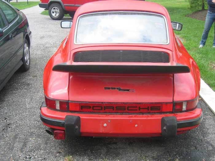

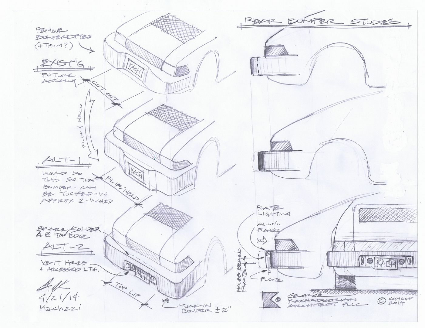

Below are some quick sketches/studies, looking seriously at the "Alt-2 scheme. I think some ventilation and license plate lighting could be worked in too.
My list of "things to do" on my car is pretty long, just day dreaming at the moment.
This is what the car looks like now.
Below is what altering the bumpers could look like, other threads show actual photos and not faked photos.
I currently have a black replacement hood on a silver car, looks cool so I'm keeping it that way.
My opinion regarding painting the bumpers black to match the accordion bellows and rubber bumper trim is simple, black mid-year cars look awesome - I think it's partly because they are monolithic and avoid the hodgepodge look of contrasting accents.
Question is; has this rear upper bumper lip modification been done before on an stock/original aluminum bumper. And if so where and when................... a link and or picture would be appreciated.

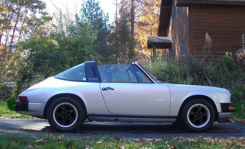

I have about a 1" tuck on my '89 -- I like the look a lot. I took off my stock bumper, removed all the rubber pieces, and made a fiberglass mold from it. From this mold I made a carbon fiber bumper and when I mounted it I tucked it in one inch. It was easy to tuck, I just drilled the bellows bolt holes farther up the bumper, along with new lightweight mounting (removed the 5mph bumper shocks). Sorry I don't have a better pic, but maybe you can zoom in on this one to see. It's painted with plasti-dip.
Yea, it looks good from here, and this is my first black bumper image without resorting to a computer program or colored markers.
One thing this image brings up is the license plate placement.
With the original bumperettes and rubber trim it's hardly noticeable that the plate doesn't quite fit the framed space and protrudes at the top and bottom.
Once all cleaned up (minus trim) plus with the rear bumper pushed back an inch the license plate begins to interfere visually.
I'm pretty sure that on a lowered car allowing the bottom edge of the plate to drop down another 1/2 inch or more could result in some scraping on drives and inclines, although I have no reports to quote in which to support this fear.
On the off-center license plate installations I can recall, the plates were mounted pretty low, I'm not aware of any issues though..............just making some observations and perhaps some conjecture.

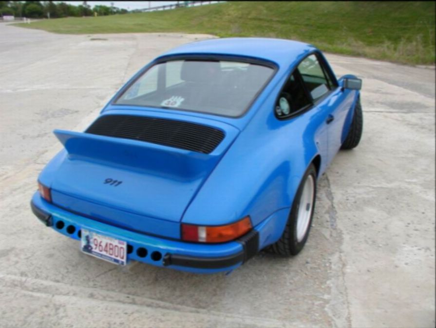

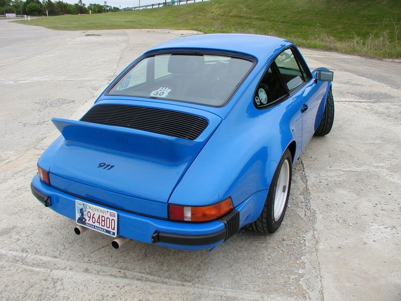

The beautiful blue car below has been posted in the forum before, and with the bumperetts removed clearly shows the naked form of the rear bumper.
Porsche Custom Photos by kach22i | Photobucket
A few holes to lighten and to help ease the rear bumper from acting like a parachute is a direct but perhaps not very sophisticated approach.
The red car below puzzles me, it doesn't appear to feature the indented middle part. Is it just the angle which gives this impression, or perhaps it's an aftermarket fiberglass rear bumper? Why would anyone put rubber trim on a fiberglass bumper? It's got to be stock aluminum.

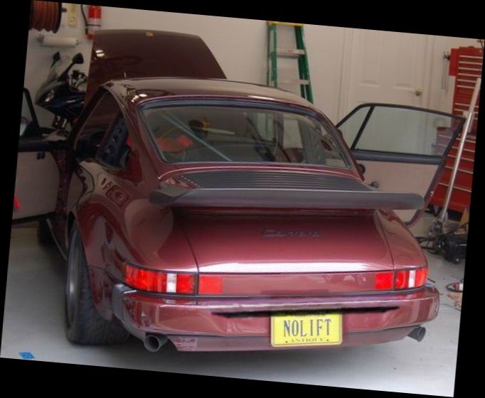

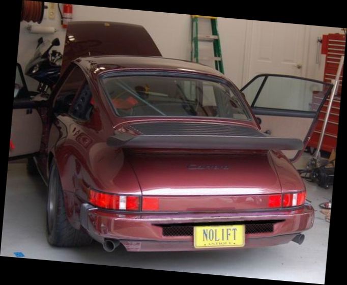

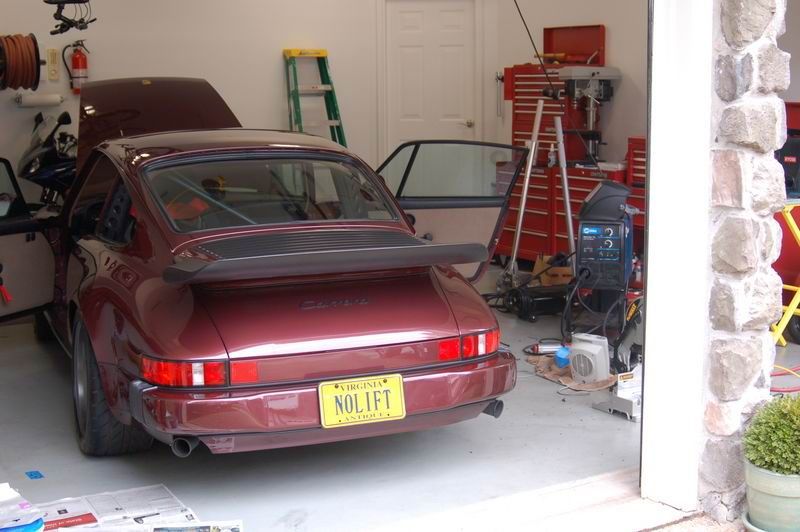

Thanks for the compliment - I stumbled on this thread and saw my car in it (nolift)...my bumper has been milled on the inside for lightness so it is a few lbs. lighter than the standard blade even after you remove the bumperettes and rub strips, and I installed the euro crush tubes which are good for about an 8lb savings.
I like your sketches - one thing I thought about doing with mine is adding the RUF slots (aka yellowbird) on the corners and then add mesh screen behind. Never thought about anything for the front.

The goal is not so much to make the bumper beautiful, but to allow one to tuck in or push back the bumper (about 2-inches) without the license plate kissing the reflector, or a shopping cart denting your engine lid.
The RUF rear bumper which I think is in one of my composite sheets is indeed a nice design, but I'm pretty sure it is made of fiberglass and offers no real protection on a street car.
The indented middle part of the bumper on the mid-year and SC's was ditched on the 964's and 993's, so the proposed modification is not out of character for a Porsche, it is just the next step.
I think the indented middle part of the rear bumper was intended to protect the license plate, with the European plates being very long. However with the addition of bumperrets (Euro and US) it seems the indent is rather redundant.
Perhaps the addition of bumperrets was an afterthought?
Maybe there was a strength increase through the curves, or less mass hung out the tail by tucking the middle part in, and that was the driver on this design element.
The Germans are not known for doing expressive things for the sake of flair, there is a hard core practical reason behind the rear bumper design, and to know the reasoning behind it will answer why it is such a curiously bent noddle shape.
