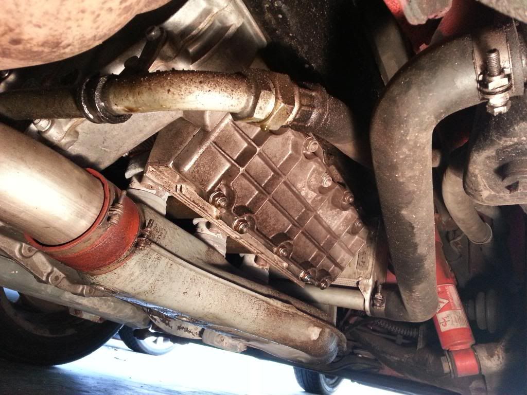

Rob, thank you very much for the detailed and positive post. It actually had me really motivated to get out and look at the car. I was even thinking, "heck, this should be easy. blown top end is not that bad".
The oil leaks I had mentioned in my original post.
http://i1237.photobucket.com/albums/...psndc33k7l.jpg

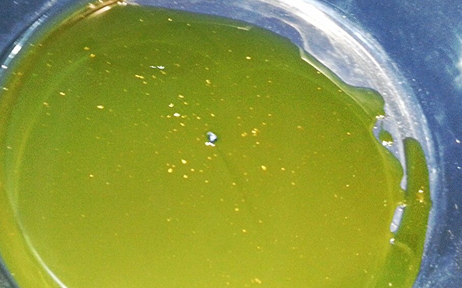

Pulled the oil filter.
http://i1237.photobucket.com/albums/...pszbk1qr2u.jpg
I then pulled two spark plugs before I lost all motivation and kicked the tool box across the garage.
So I then talk to my buddy (who's built 20+ engines now) and he feels since the car was running great last week that maybe a rod cap came off. His big concern is the condition of the crank. If it's nicked I'll need a new one.

cgarr 05-15-2014 07:03 PM
Whats in the oil? can you tell? alum etc? Normally if you get chains slapping around they will hit the chain case and take some aluminum out of them. These motors are pretty bullet proof, but tensioners do fail and make a hell of a noise.

A&F 05-15-2014 07:11 PM
Gold. I think it's brass. I left it in the oil pan as it is. Filter is in a bag.
cgarr 05-15-2014 07:16 PM
Well you got, rocker bushings, chain idler sprockets, dizzy drive gear, rod wrist pin bushings, what am I missing?
