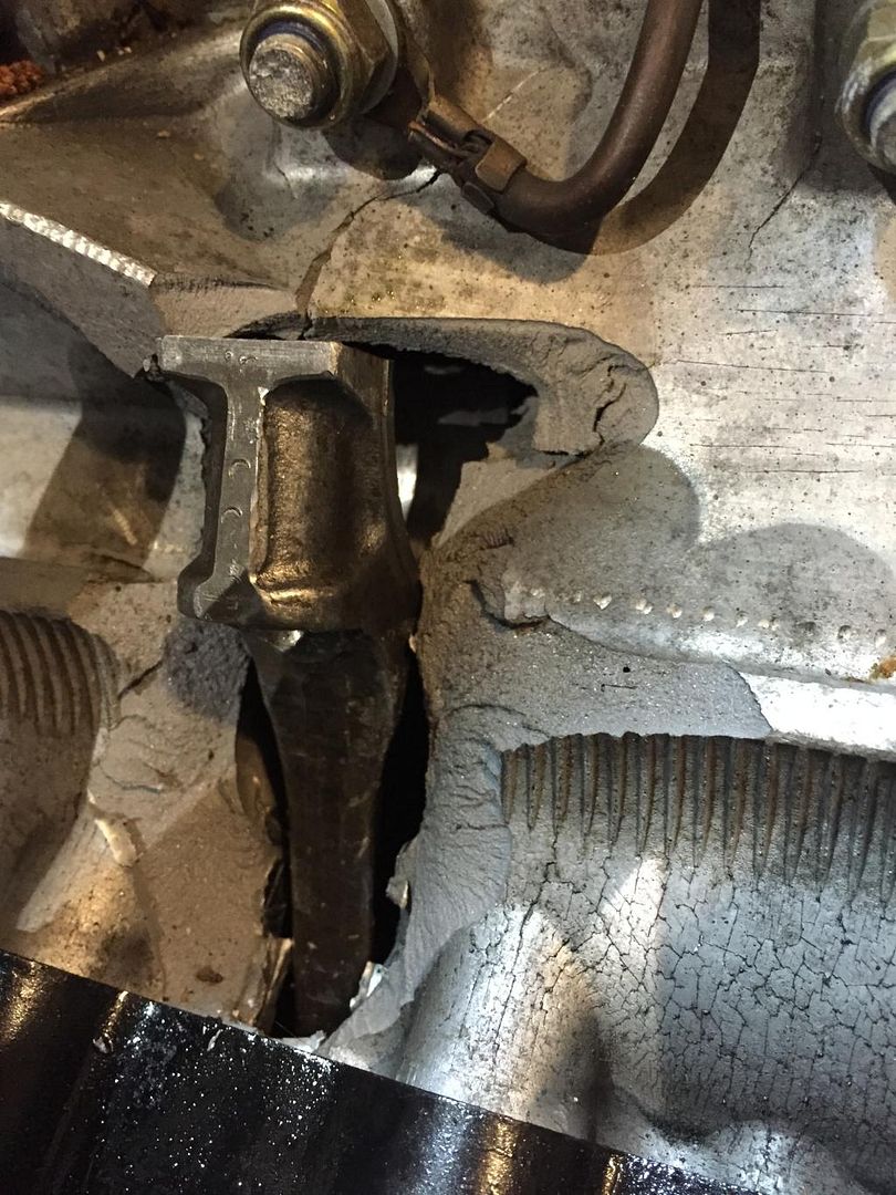

Boom-chuck-a-Rod
So it's been a while. The car has sat as I have been tied up with other projects. Last Saturday I went ahead and pulled the engine. It did not go well.
http://i1237.photobucket.com/albums/...psaulqe9gg.jpg
http://i1237.photobucket.com/albums/...psaux2w450.jpg
http://i1237.photobucket.com/albums/...ps4z8e3xqm.jpg
http://i1237.photobucket.com/albums/...pseb3k7ak2.jpg
http://i1237.photobucket.com/albums/...pseytdfjhq.jpg
http://i1237.photobucket.com/albums/...psrep11bcx.jpg
http://i1237.photobucket.com/albums/...psr8hjghrf.jpg
911nut 12-15-2014 06:28 AM
I literally screamed when I saw the rod hanging out of the case.
Here is your opportunity to build up a new, kick-ass engine.
Best of luck to you.

Holy wow! See if you can find a short block, or a whole engine.
A&F 12-15-2014 06:48 AM
Yeah, I'm going to disassemble and inspect it. What portion of the crank I can see in my new "inspection" window looks good.
Anyone have the run down for what are the going rates for 3.2 cores, runners and cases?
Can I use a 3.0 case? (930 is the same case as a 3.0, right?)
Cairo94507 12-15-2014 06:54 AM
Oh my.....that is just sad. I can't believe that rod punched a hole in the case. Look at the positive side of this, you have a beautiful looking coupe. Now you can build a fresh 3.2 or even a 3.6 and install it and know you have a tight, fresh motor. On the other hand you can look for a used, running 3.2 and just bolt it in and drive it. If it were me, I would build a fresh motor salvaging what parts you can from your engine and then enjoy the car.

porsche930dude 12-15-2014 07:51 AM
well that answers youre question. Any recourse with the engine builder or are they already out of buisness?
