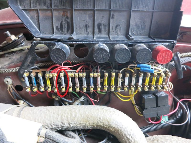

So at first I thought it was the fuel pump. So I started with running power directly to the fuel pump fuse (circled in red) and the fuel pump fired up.

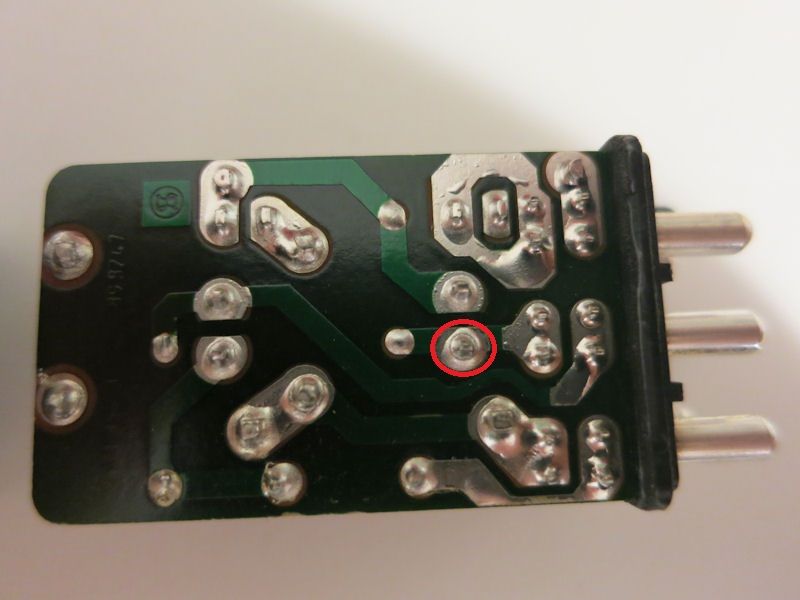

So next to inspect was the DME Relay, it doesn't matter what I searched when the car doesn't start everyone mentions the relay. So I not only removed the DME Relay but pulled it apart and looked at the solder joints. They looked fine until I zoomed in on the picture, I circled one of the obvious broken solder joints. Compare it to the one directly above and you will see the break.
So I do not have a Soldering gun so I will have to borrow one from a friend. For today I want to figure this all out so how can I by-pass the DME Relay a quick search shows me how to jumper the DME-Relay plug to fire up the fuel pump.

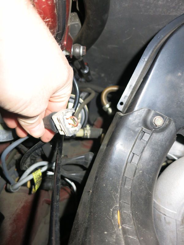

I hope I didn't do this last time I did a valve adjustment but the top two wire part of the plug was broken pulled apart where it should not have.
