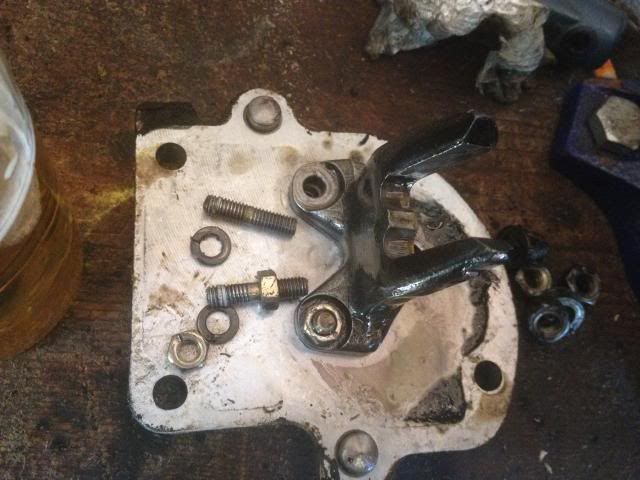

Is this the one your talking about?
When I re-assembled mine I just made sure the gearbox was in neutral.

If it's that one, just put it in neutral and remove it. Be sure to have a new gasket on hand, and clean the mating surfaces of any remaining bits of the old gasket. I don't think you're gonna be able to see anything of value through that opening, but there's no harm in looking, I guess. I wouldn't remove the "finger" piece from the plate. You can see in the picture why not. Those pulled threads showing on the stud ain't pretty!

No it was the plate on the bottom of tranny. Just want to check fork
Thanks I think that's it
