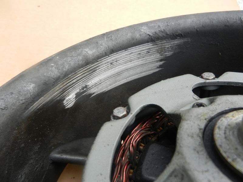

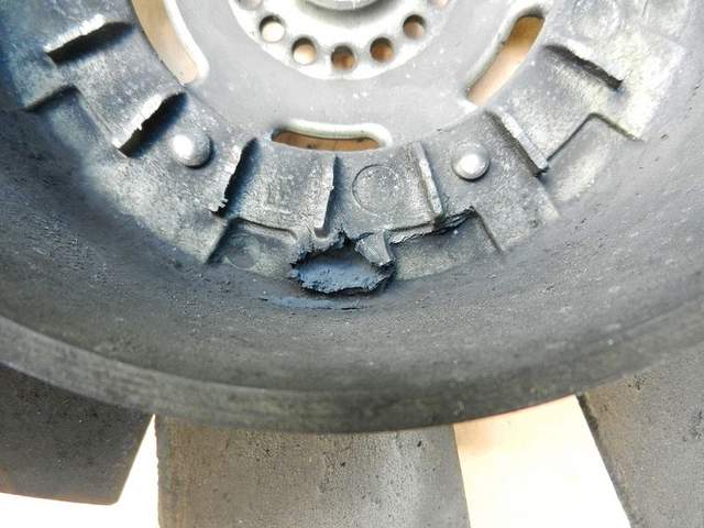

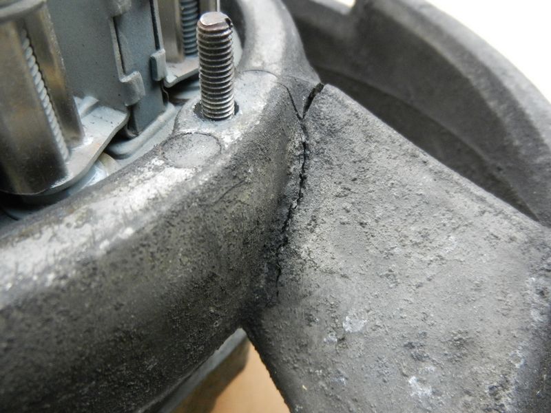

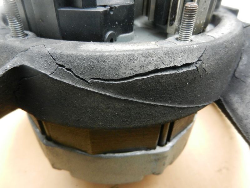

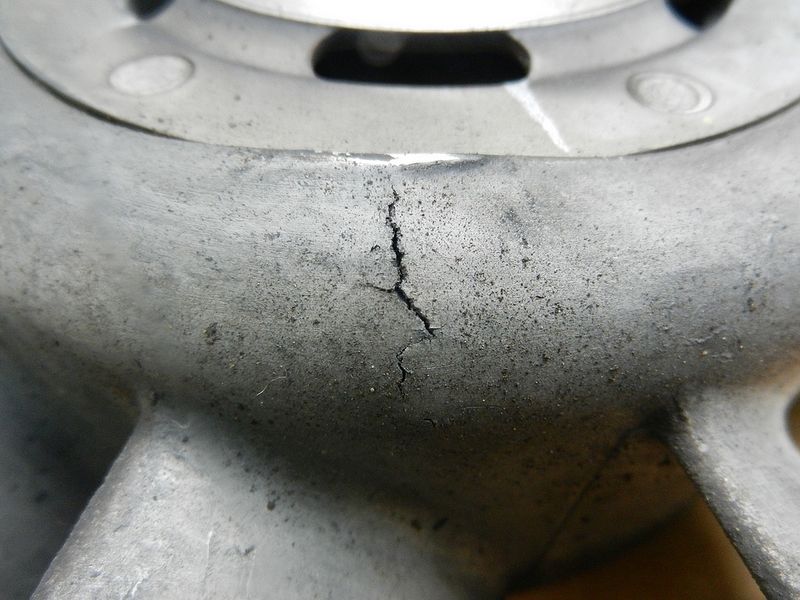

Shane, if your "clanking" sound is similar to a tingy bell, Chris can be right. If it is the fan hitting the fan housing, the visual for the two parts making contact is usually around 1 - 2 o'clock inside the fan housing. Contact occurs from the fan housing first cracking, then warping, that warping allowing the fan shaft to go out of center and so allowing the fan to hit the housing.
If it is this, it's a very simple fix. And you can find all the guide info here in the forum so I suggest no worries.
Here's a fan and housing from a 1985 3.2 that made contact.
Initial reason for contact...
While a warped housing can settle into place and last for any length of time including years, the sooner the issue is addressed the better chance there is of not having to buy a new cooling fan. The reason for the housing taking the fan down with it is frictional heat --- it eats up the rear edge of the fan blades (not easily seen but can be felt) and can cause gas/air pockets inside the fan to blow out as you can see below.
