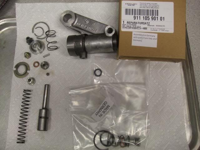

Old 08-24-2014, 03:03 PM
Join Date: Jan 2011
Location: Gulf Coast FL
Posts: 1,494
Here's what you need (part number and kit contents in bag) along with a disassembled view
and how to hold the chains (~2" bolt and nut) and you can use a big C-lamp to compress the rebuilt units and then slip them in
no sense in not doing both
Old 08-24-2014, 03:47 PM
Join Date: May 2013
Posts: 883
Thanks- I saw tha Porsche make a special tool for that, I'll just get a bolt and nut like you show.

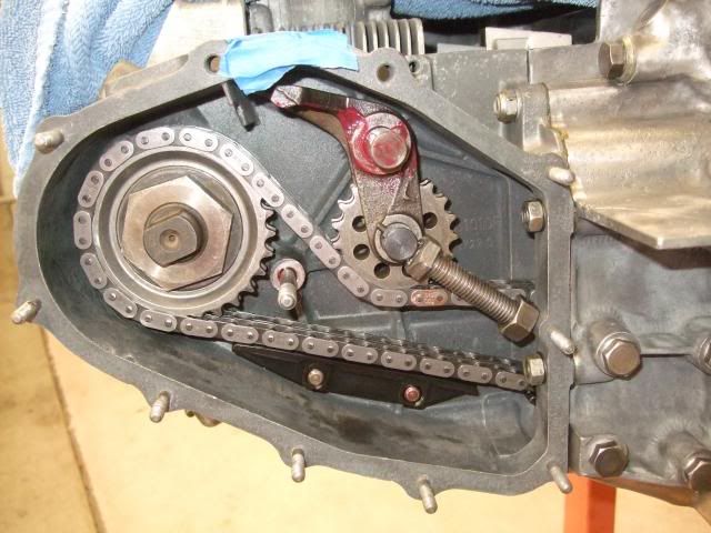

Old 08-24-2014, 06:59 PM
Join Date: Jan 2011
Posts: 1,494
Nut and bolt works on the right side tensioner just fine, and BTW this pic is from an engine in the car tensioner replacement
Old 08-24-2014, 07:40 PM
Join Date: May 2013
Posts: 883
Do you start the nut and bolt loose and then unwind the nut until it starts to take the tension off the tensioner? Or just put it in snug and compress the tensioner to get it out?
Old 08-24-2014, 08:04 PM
Join Date: Jan 2011
Posts: 1,494
Takes a little finessing, but make the nut/bolt a little longer than it needs to be and then slip it in, you want the lever/chain tight.

Old 08-24-2014, 08:34 PM
Join Date: May 2013
Posts: 883
Ok so I have progressed on this front after many days of doing other things.
I have used zip ties and a bolt between case and idler arm to hold the tension on the chains.
LHS
RHS
I had a bit of trouble getting the tensioners out until I realised that it is a case of gently does it and make sure you pull out on all sides parallel, then it just pops out.
I bought 2inch/50mm nuts and bolts but I had to cut the ends off with a hacksaw and then wind the nut out a bit and just work it in to get it snug. I think I cut about 10mm off one and 5mm off the other. The RHS was a little dicey to pull the tensioner out and keep the nut in place but it all worked out. Thanks to eastbay for the tip!
Still waiting on the rebuild kits to arrive...while I am waiting - how do I remove the old gaskets? One has stuck to the chain cover, and one has stuck to the case. It's OK along the 'straights' but around where the studs go through the cover, the old gasket is very firmly attached.
