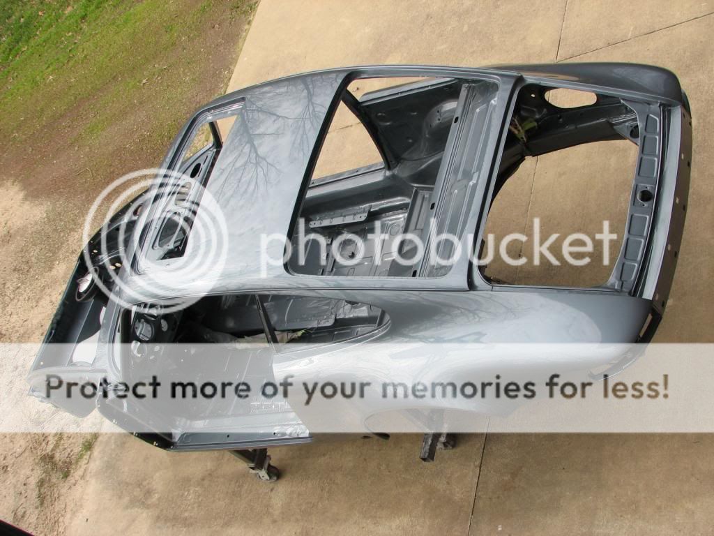

The perfect storm care together this summer, and the opportunity to get my car done presented itself. After being subjected to the elements for 6-8 months after hurricane Isaac dealt us a blow,and she lost her cover due to construction of new house, showing the first signs of cowl/fender rust and a bubble at windshield base i knew i had to nip it in the bud. Well,a good friend is a master body tech, and my cousin owns a first rate hotrod shop. I loaned my glass blasting rig to said buddy for him to blast his 54 Austin-Healey 100-4. On the stipulation that when the time came he do the repair and body work on the 911. I've also blasted at least a half dozen cars for my cousins shop,and seeing the cars coming out , i knew i wanted him to paint it. Long&short,buddy goes to work for cousin, i'm fixing to start a long summer tour,and car starts to show signs she needs some love. You know, leaking at seals, CIS tuning issues popping up. So i pony up a depo$it for materials, drive it to shop( cursing /praying cause its running crappy), and get to work.
The patient
After a day had bumpers & fenders off.
I hit the road, on days off i put parts into my pelican shopping cart, keep tabs back home,these guys being friends,i can hide under the guise of general BS. Oh yeah, whats up with my car? Fast forward seven weeks, i get home and pick up where i left off,oh wait minor drama, buddy decided to go back to collision work after a month,but he did his part and all my bodyworks tight. Time for me to do my first engine drop to reseal my motor and eliminate a bunch of possible sources for my running problems, i suspect lambdas shot, but we'll get to that later. So, back to damichi i go.(thats the shops name Damichi Motors,Hammond La. Facegoogle em) to get my engine drop plan together, and what do i spy under one of the frame machines?
To be continued. I gotta transfer some pics to keep the continuity going folks.

If you look closely at the first pic,notice the difference in the color of the frt valance. That is slate,the rest of car is venetian. I think i had the car a couple yrs before i even noticed the diff. In color. My first tipoff was when i ordered DR. Colorchip using my slateblue paintcode in trunk and it was a couple shades light. I like the venetian better and thats what i'm going with. With my budget i MUST avoid that slippery slope.

Update. Got the engine home, cleaned a lot, disassembled CIS into manageable parts, after inspection sent a couple of fuel lines in need of repair to BoxsterGT for a little love. So far got the crankcase breather, oil cooler seals,t-stat oring and oil pres.switch. Installed injector sleeves today. Tomorrow its flywheel and pulley seals.
Body's coming along too. First round of primer and blocking done.
