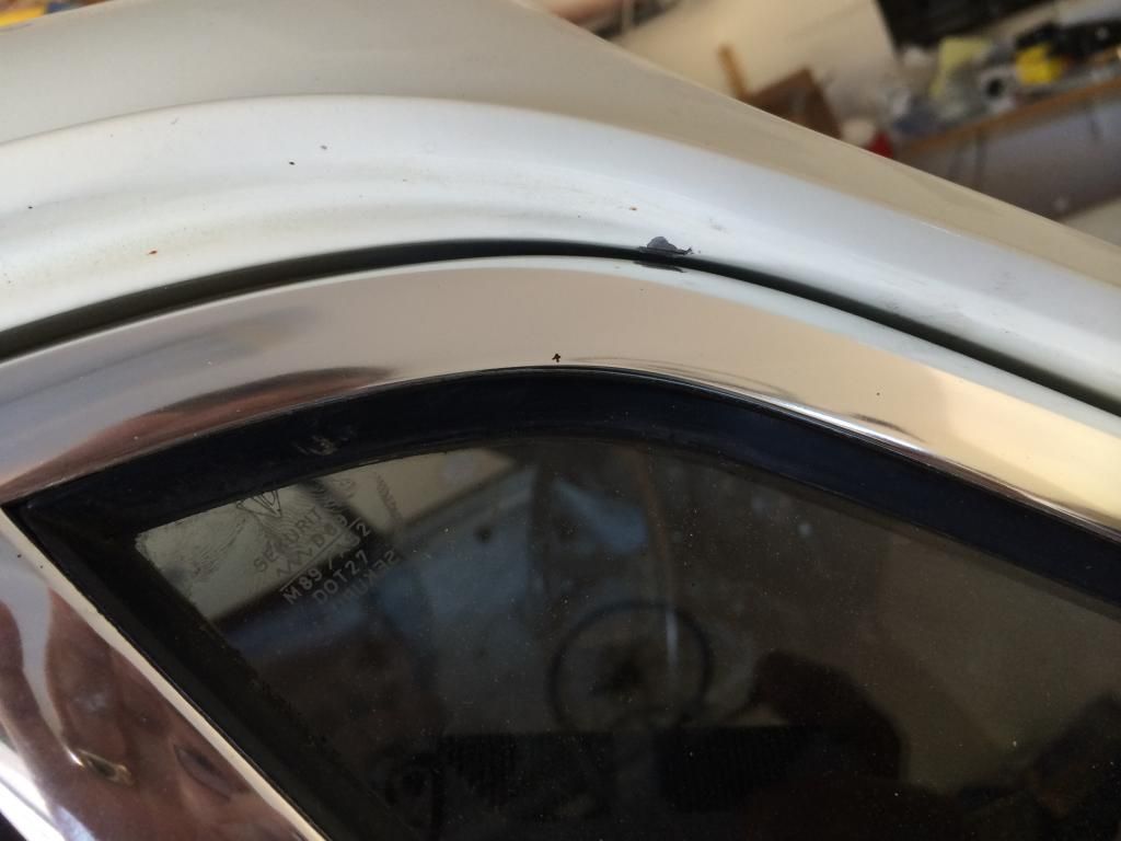

I finished under the car last night and put it on wheels. Here is a pic of the passenger door and where it was hitting. I say was because it isn't hitting since I took it off the jack stands. The jack stands were under the torsion tube and behind the front wheels where the pinch weld curves in around the wheel well. I guess the body was flexing.
[IMG][/IMG]

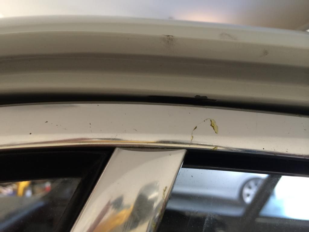

Here is the other side (driver) where it's hitting, this side looks like the window is tilted in too far as well as too low in the back. It's hard to see how much it's hitting.
[IMG][/IMG]

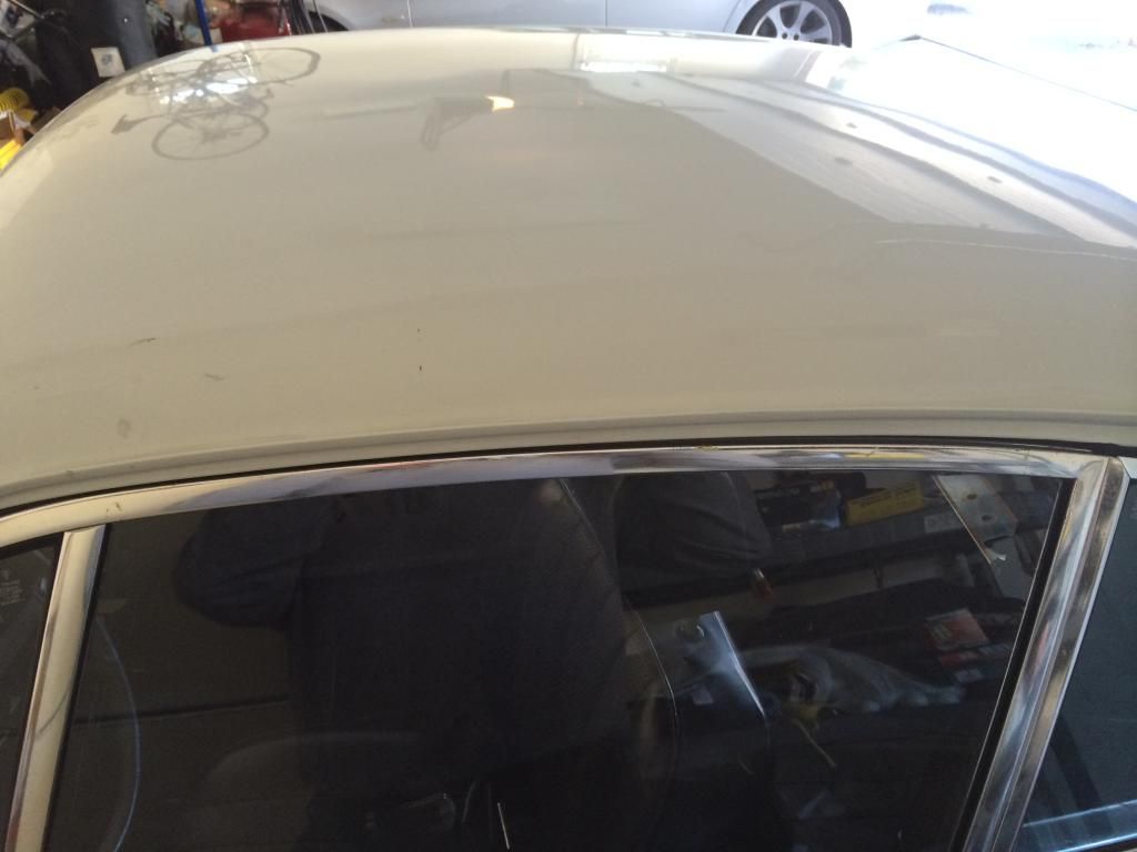

View of the top line. The back looks low, but I thing this door needs adjustment too. I'm taking it to have some paint work done and will ask them to adjust the door:
[IMG][/IMG]

Look at the line between the car and window here....
Cars obviously flex to one degree or another. The older a 911, the more flex that can be expected. From photo above, I draw two conclusions. 1) Window frame is out of wack leading to the opening of the gap between the frame and car towards the front and towards the rear.... and tightness of seam at middle. 2) Car is bowing downward toward the center (cabin area) causing roof to move down and so closer to the window frame at center. (Would be interesting to know where jack stands were when frame was hitting car. That might add valuable info as to what's going on.)
Both 1 & 2 are out of my realm of expertise to address but for the observations made here. This is not a matter of frame tilt to be DIY adjusted. Am thinking both scenarios are best dealt with by discussing them with a body shop that has Porsche experience.
Assuming car is bowing, path I would consider first would be to adjust shape of window frame along top to match car's line. This does not diminish what may or may not be done concerning the bow of car's body --- am only focused on fit of door & frame to car here.
