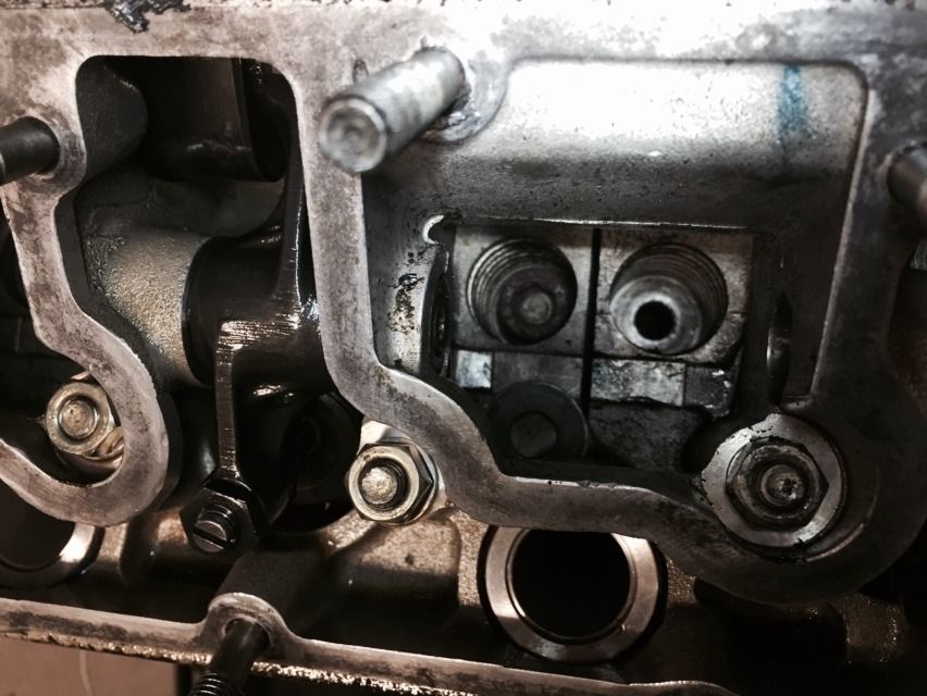

Long and the short of it... my new to me 1984 3.2 with 58k (documented) miles has a missing head stud (someone left the washer behind however...), and pitted cams.
My thought is dirty oil at some point as far as the cams go. This makes me wonder about what the rest of the engine looks like. Compression was 155-165, leakdown 4-8%. No smoke telling of bad valve guides.
I am thinking of 964 cam regrind or webcam 20/21. Of note I will have SSI's, M+K 2:1, SW chip, cut airbox (cup style). Plan is for street/HPDE compromise so the SSIs were chosen with midrange and heat in mind, I am not out for max high RPM gains. I am also ordering the engine rebuild book by Dempsey (although I will not be doing this myself).
So my questions:
1. Beyond the cam and rockers, anything else to look out for? (I am expecting to do exhaust guides at least, resurface head, APR or equiv upgraded head studs)
2. Crack the bottom end? new rod bearings? (scope creep!!! getting into 3.6 territory when you factor selling the 3.2)
3. Swap to a 3.6? (~20K cost, plus scope creep like bigger brakes)
Thanks for any thoughts. A good discussion of the same type can be found here: Budget 3.2 head stud replacement project

The pitted cams/rockers are more than likely from the wrong oil not dirty oil...a guess would be a non zddp type oil. That's where you see the damage if the oil lacked zddp.
The lack of zddp will not cause an issue elsewhere...it's a cam/rocker specific ingredient for flat tappets.
With 58k on the motor I would not crack the case if in fact you find no other wear items in the heads (oil issues you mentioned).
Do you know any history as that helps with the decision on upper or total.
The crank/bearings/bottom on the 3.0/3.2 are known for their longevity....I'd only crack it if a known issue existed.

The PO did a claimed 4 autocrosses and 2 HPDE's. I changed all fluids and then I did one HPDE. I am thinking over-rev risk.
The oil residue in the lines post engine removal was classic for water in the oil... i.e. not heating the engine up properly. Likely part of why it had so few miles.
PO swore by Rotella T diesel oil (15W40). He was sold on that based on a reputable west coast shop that did a lot of work on PCA race cars and swore by it also. PO only owned it for 6K miles and maybe two oil changes. I used the same oil for 2k miles (changed the oil after getting the car). Good discussion here: Diesel engine oils, good for aircooled Porsche?
Not trying to start an oil war here, but how long do you think it would take bad oil to do this kind of damage?

Change the head studs, I recommend Supertec, change cams and chip.
Leave the bottom end and set a side a budget for exhaust valve guides if they are needed. The valve guides are easy to check when you have the heads of.

I just went through this. I had cam tower leaks at the rocker shafts and pitted cams resulting from blocked spray bars. This was due to a poor top end done by the PO.
I decided to rebuild vs swap. I did not crack the case but did everything down to and including rod bearings. Added 964 cams, Supertec head studs, ARP rod bolts, etc etc. I've paired it w/ custom SW chip, George's headers and a Dansk 2 in / 2 out. Its not got the torque of a 3.6L but its new and it is strong!

I personally think the pitted cam issue isn't oil type related. There are way too many pitted cams out there, but the rest of the lobe and rocker face intact, for this to be a lack of ZDDP. If you've ever seen a flattened cam before, it looks nothing like a pitted cam. I think the pitted cam issue is due to the surface hardening of the cams not being deep enough. JMHO.
As far as the rebuild, get some JE 98mm 9.5:1 pistons and have your cylinders bored and plated. That will run you about $2K and gets you 3.4L and a good jump in torque. Add 964 cams and a tuned chip and I bet you'd be close to a stock 3.6.
