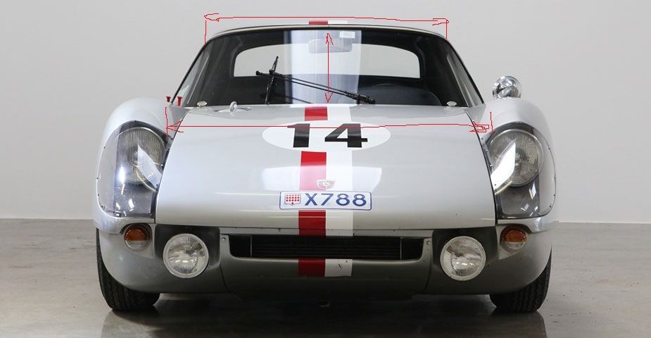

Wasn't sure where else to post this odd question, but since there's not really a location dedicated to 904 topics, I thought I would post it here.
I'm guessing I won't get a lot of response, but I'm looking for some dimensional verification on a 904 windscreen. if anyone has the ability to pull some numbers for me it would be greatly appreciated. Directly up the middle, across the bottom and top (as best as possible) and if it's possible to get a depth at the front, as if it were laying on on the ground, that would be great too. Taken from a plexi windscreen will be just fine. Just trying to verify what I'm chasing.
Thanks for any help! I know it's a weird request.
Here's a visual with not so straight dimension lines scribbled in...

Did you ask one of the guys with 904 replicas? There was one from the UK on Early S Registry and there's another here in off topic.

These prints have a scale on it so you may be able to extrapolate. Another option is to reach out to Porsche they may be willing to offer assistance, ya never know.

I bet I've looked at that picture a 100 times and never noticed the scale on there. DUH! That might help me, assuming that the drawing is accurate to the real car, but scaled.

Mine is now safely tucked in the garage. I'll take the measurements for you later this week when I get home.

We've got a replica in the garage, may even have an extra wind screen. I'll get some measurements.

Okay. Straight measurements taken on the car with no screen installed :
Vertical 24"
Top across 40"
Bottom across 48"
The gage cluster was kind of in the way for the bottom measurement but it should be close.
