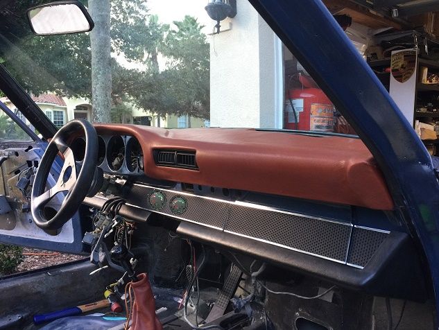

wachuko 12-18-2015 07:01 AM
Originally Posted by RNajarian (Post 8860883)
Great advice Wayner, you motivated me to get some "insurance" as well.
My car has the dealer installed air conditioning unit installed. So I was able to buy a VDO bracket which fit perfectly in the space of the never used ash tray.
I installed an OEM 55 mm VDO voltmeter and an OEM VDO 55mm outside temperature gauge
Doesn't look too bad. I love knowing the status of my electrical system
http://forums.pelicanparts.com/uploa...1446483663.jpg
I like that... Looks like I will be making one more modification to my RS build... I have plenty of space since I deleted a/c and heat in the car... I can use those gauges in the dash trim... just drill the trim in the area where the heater controls were before...
The gauges can be found on ebay (copy-cats of course) at a very decent price... I bought a set to do the control panel for starting the 912 engine on the stand...
I will get the volt meter as well...
http://i151.photobucket.com/albums/s...psvl6pjzpo.jpg
Install them here (lousy pshop attempt...)
http://i151.photobucket.com/albums/s...ps3swk7r4c.jpg
Thank you!
