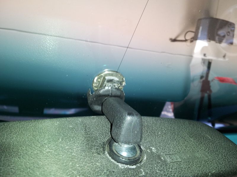

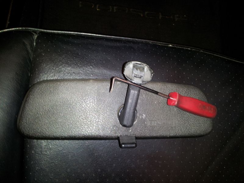

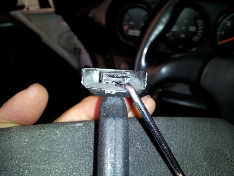

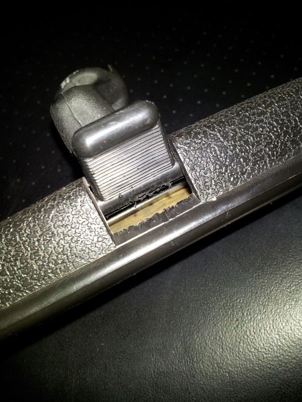

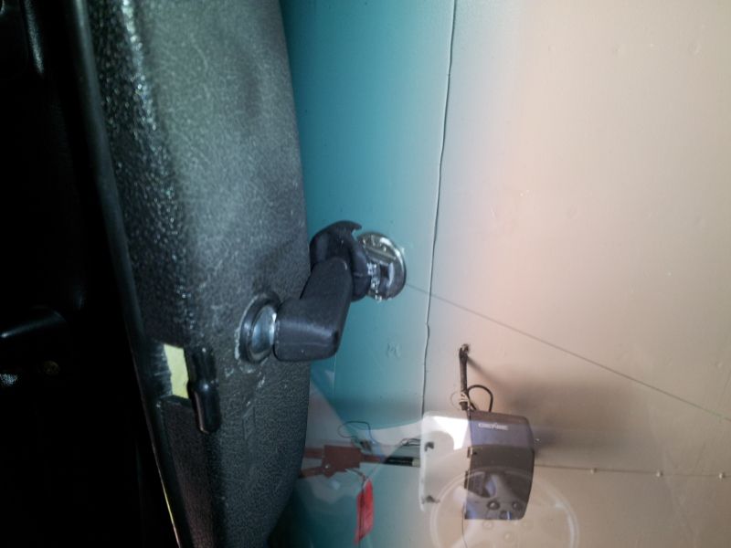

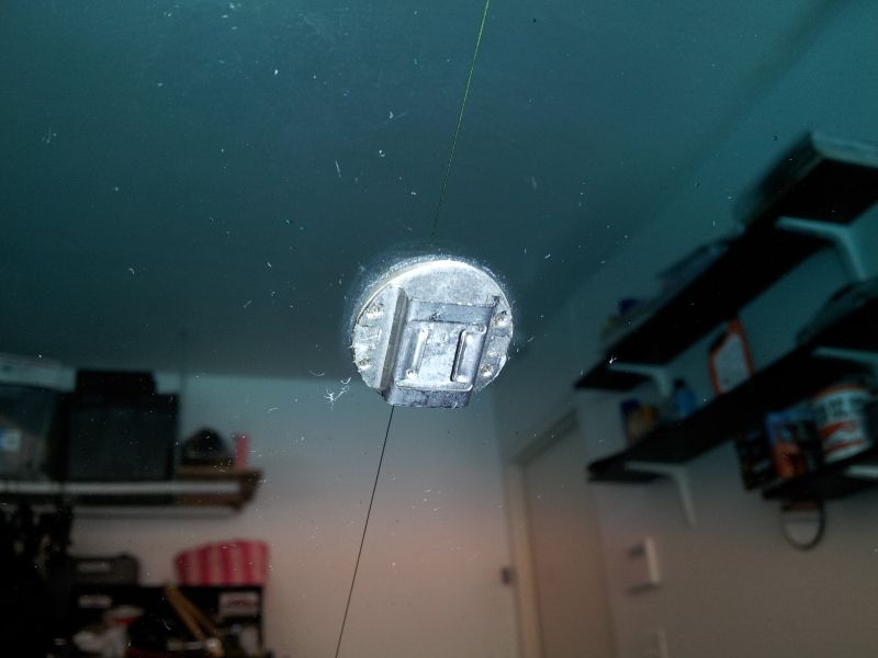

Make sure the lever is set in place
Use a pick tool to release the locking tin tabs
Slides upward
Closer View
Removed, the tab/s are on the window mount
Break a Leg Brother!
