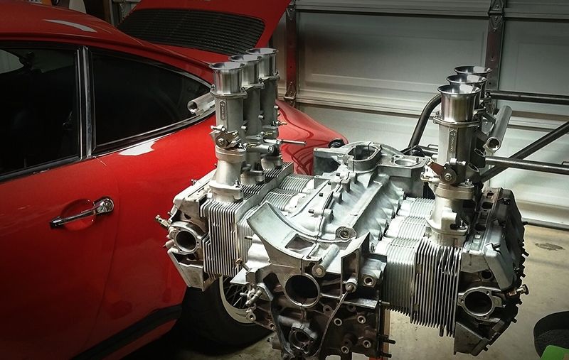

Wanted to share some exciting news with the fellow Pelicans, the Rasant Engine Management system is now up and running on a set of 46mm PMO ITB's! The combination of this Engine Management kit with ITB's has completely transformed the otherwise stock 2.7L. Throttle response, acceleration, and sound are as if it's a completely new engine.
With these installed on my engine it offers a much better baseline calibration for those who want to install with either ITB's or the stock intake manifold. Either route is sure to please! I will upload more photos and dyno data soon with the ITB setup.
We have our introductory offer extending to the end of the year. Please email me for pricing on your vehicle.

46mm carburetors would drown a 2.7. I'm impressed!
Anxious to see the data.

That certainly looks good! Is there any loss in low-midrange with the ITBs? Hopefully your dyno plot shows before and after

Thanks guys! Yes, the 46mm ITB's probably aren't ideal on a 2.7L.. The next build started that would really showcase the Engine Management System (ITB's on a twin-plug 3.5L). While waiting on cams the ITB's went on my 2.7L . Here's a sneak peak of the new build:
Even the 46mm ITB's are working very well on the 2.7L. There's a small amount of lag when going WOT at very low RPM's but I'm working on tuning to improve it. Everything above ~2000RPM is improved and that's with minimal tuning time. This is really a testament to the capability of the Infinity ECU. Very interested to see the dyno data as well!

Are you using MAP or TP for your fuel table with the new ITB? When speaking with the guys at AEM they recommended TP as the primary and MAP as secondary for elevation when going ITB.

Great progress. The hesitation is mostly due to the large swept area of the 46mm throttle plates compared to the ingested air requirements of a small motor at low rpm coming off-idle and closed throttle. There are ways to tune around it but you have to be creative. In a high speed datalog it should register as a lean spike.
You are very correct that the fuel requirements and map/table shape for common plenum and ITB are very different. Amazing what good resonance tuning can do.

Hi David, good to hear from you! I started tuning by MAP alone which of course was erratic on the transients. Then I started including TPS compensation for enrichment/fuel cut on throttle transients (very easy to do with the AEM Infinity). This seemed to work well.
I was also suggested to try tuning by TPS. I updated my tune and have been running this configuration for about a week, and it seems to be marginally better than the MAP + TPS compensation. It could still use some refinement however.
I will keep trying both configurations and report my findings. That's a good point about elevation. I'll have to take it up to the mountains one of these weekends to see if one prevails.
Nathan, thanks for the email! Hope to work with you on your 2.7L + ITB's. I'm sure you'll be happy with the results.
Thanks Jamie! That explanation helps quite a bit. I can improve data log frequency by logging on a USB memory stick, rather than the PC. It would be interesting to see if that helps narrow in what portion of the maps will address the lean tip-in.
