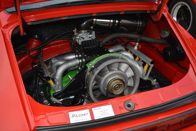

Shoot me a PM or email Andrew@rasantproducts.com for pricing. We're offering a special price for the first batch of customers. A TWM ITB and twin plug setup is very feasible. It's a project that's in the works now actually. I'd love to make a turbo kit as well. Boost control with the Infinity ECU would be convenient. Our kit provides all the sensors. It could be configured to run with something like an EDIS setup too. RStop: I could send a couple coil options for you to try? I have two different lengths of the same Bosch coil. Agreed on the ITB setup, I believe it could be an identical harness. As Andy said, it's 185. Mine is mounted behind the passenger seat. It's a nice discrete location. ivanuf: I certainly don't want to discredit another Pelican's work. The big difference is that this includes coil on plug ignition and a newer ECU. If you're interested shoot me a PM for pricing. Thanks all!

Hi all! Great turnout at the Pelican Cars and Coffee last week. Nice to meet fellow Pelican members. Wayne's team did a great job setting up the event!
The engine management kit received really positive feedback. I believe I've answered everyone's PM's and emails. If you still have questions or are interested in a kit please send me an email directly at Andrew@rasantproducts.com Thought you would all enjoy some photos! ![]() ![]()
