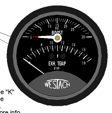

I came across this on the Westach web page. It is 3" which is a little smaller that the 3.125" Porsche clock gauge. With a little work it would fit in nicely.
It is nice because you see boost and EGT on the same gauge. If your really insane you could put a 6 way switch to monitor all EGTs.
Tony
