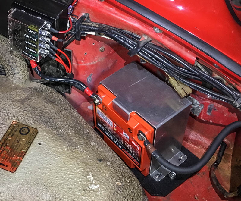

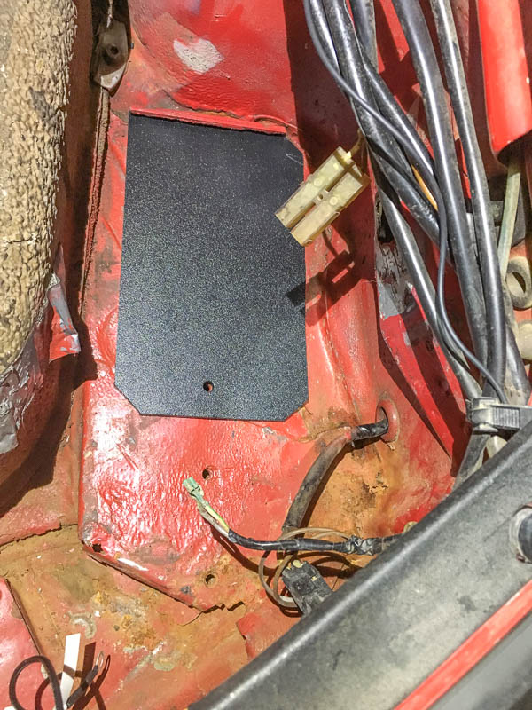

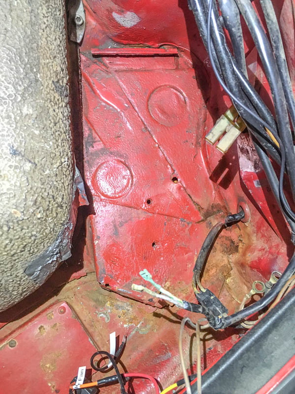

I'm in the middle of a stereo install, and it seemed like a good time to finally remove my killswitch as well as mount my battery properly (it was being held in with a tie down strap for a while). I plan to duplicate this solution:
My Odyssey PC925 install

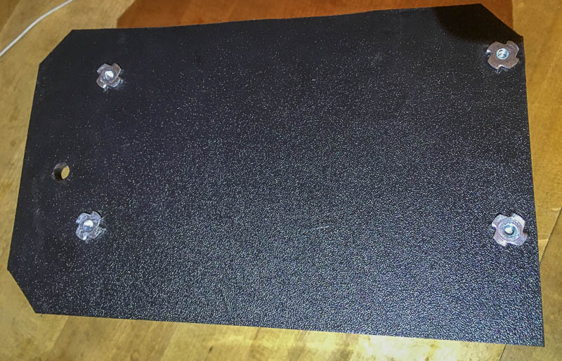

I bought a 12" x 12" x 1/4" sheet of HPDE (though ABS plastic would work just as well), some assorted metric T-nuts, and got to measuring' and cutting'.
The quarter-inch sheet fits the stock mount very well, particularly if you lift it up past the little lip in front. No wiggling. I plan to put a layer of foam/CCF under as a guard against chafing and rattles, but I suspect it doesn't need it.

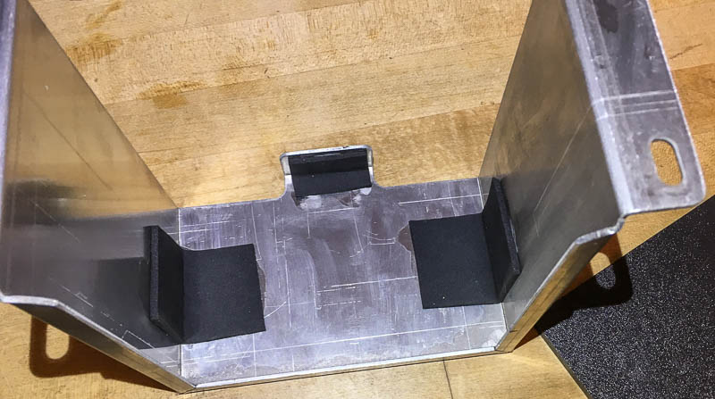

I wound up buying a mount tray from Quality Power, which was dumb, because it's just a marked up version of Odyssey's mount tray that was pointed out by James Brown in the first response of the thread...Oh well. They actually sent me a steel tray, and when I notified them, they just sent me the aluminum mount gratis, so kudos to them regardless.
I added some closed cell foam to the inside to ensure a snug fit and maybe prevent rattles. Also a shot of the T-nuts hammered into the base. I probably should have put some foam on the bottom as well to protect the paint underneath, but this thing is very snug installed, and does not budge a millimeter.
