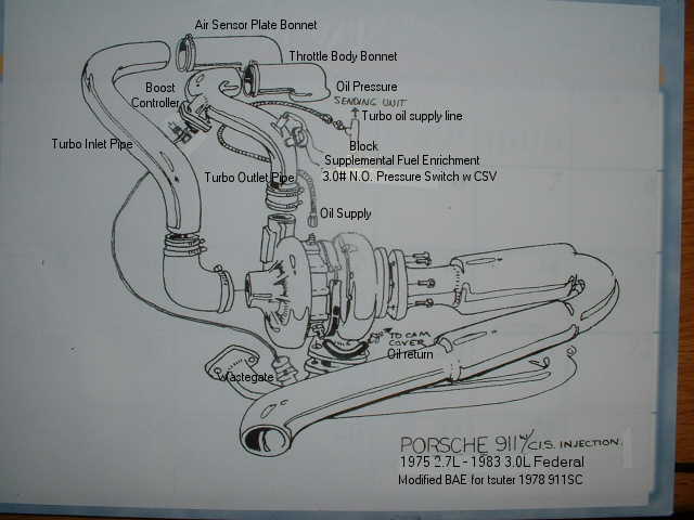

911SC Turbo Schematic
Figured out how to post a drawing of the turbo. Will try and take pictures later. Thanks to Ray and Souk got the camera!

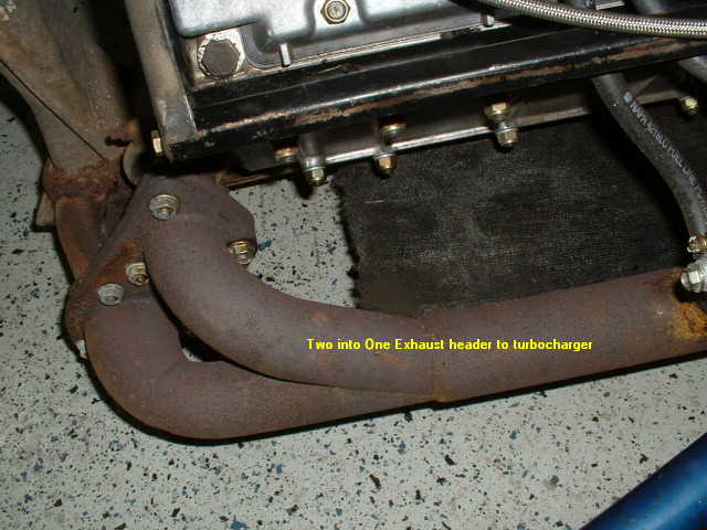

More of the wastegate
Two more of the wastgate positioning and custom exhaust. Causes the china to rattle and scares the neighbors.
And the exhaust...
Two into one Exhaust header:

tsuter,
Could you tell me at what rpm your on boost?
And your compressor housing A/R? turbine A/R?
...and a pic of your exh Y pipe?

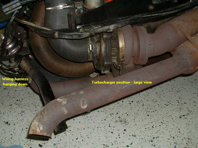

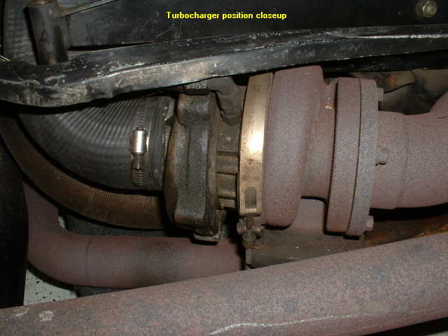

Turbo Position
Here is a shot of the turbo positioning at left rear.
Here is one a little further away. No stainless for me yet. Maybe that iron will rust through one of these days!!

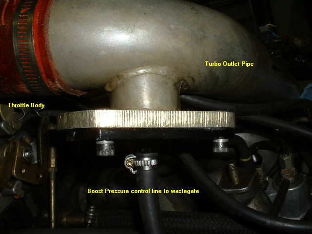

Boost control and Enrichment
Here is a photo of the boost control line on the Turbo Outlet pipe just before the top of the throttle body. The flange used to have a large mechanical BOV which I removed as it was venting enriched Air/fuel mixture onto a hot motor - bad idea. So now the line goes to the wastegate. I will be putting an additional boost controller in this line. TBD.
This next image is the fuel enrichment set up. It is a 1973 Bosch 914 CSV activated by a 3.0 lb pressure switch. Both are located in the Turbo outlet pipe before the throttle body. At three lbs boost, the mixture is enriched. I used to have two of these . One at 3 and one at 7. But now just one at 3.0 lbs.
