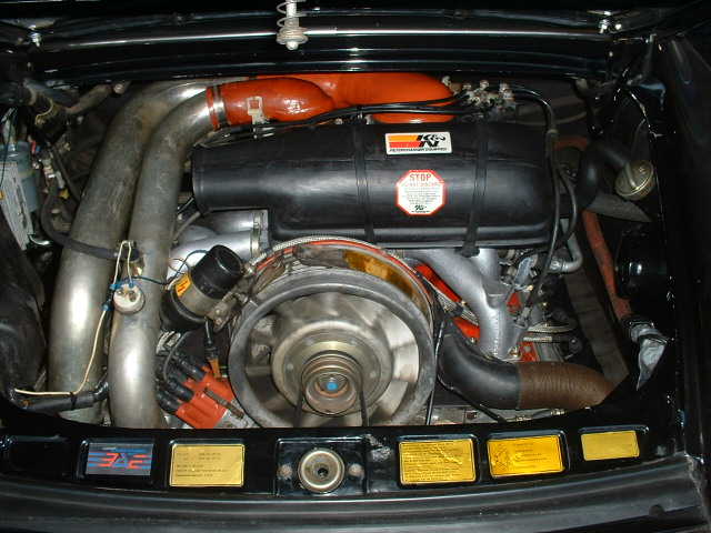

It looks like a SC turbo install. Throttle Boot(1) appears to be silicone BAE, Inlet/Outlet Pipes OK, Turbo unknown. No fuel enrichment. Hoses not routed nicely. Overall - pretty ugly. But if I was building one, those pipes would be useful as would the silicone boot(s)?

I like the overall car layout, so it might be an interesting project. I'm having trouble with the vehicle ID # He says it's european, but the ID #'s don't quite add up. It's got 93 in the location that says it's a 930. Someone with more knowledge then I have would have to noodle that one a bit. Thanks for the input.
Old 03-05-2003, 05:27 AM
Sure looks like an SC motor to me. A 1984 911 should be a Carrera w/ 3.2 motor.

Car delivered back today from Kelly-Moss in Madison with new Sachs Power Clutch and rebuilt 915. I can't believe the old clutch was still alive. See earlier photo.
Reassembled turbo components. Photo shows single stage fuel enrichment on turbo outlet pipe. 3.0# N.O. pressure switch activates the CSV. Running too rich right now under boost. Got to find a smaller injector hopefully without having to fool with banjo connections. Also have not hooked up new boost controller.
Fan and housing scheduled for some powder paint as are the inlet and outlet turbo pipes. Need to make decison on installing a Bailey or Forge type diverter valve across these pipes to vent pressure when shifting and off throttle.

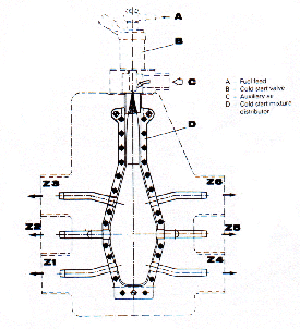

Possiblly if its a couple weeks out. I am removing the fan and housing this weekend and the pipes for painting. Got a new air box as well to go in and I saw that the new one has internal fuel runners right to the six intakes from the CSV port. That is very interesting as the old CSV just opened into the main cavity.
So now I'm considering using the primary CSV as my fuel enrichment injector instead of the current one piggy backed on the turbo outlet pipe. Still activate it at 3.0# with the same pressure switch. Without an enriched mixture up in the turbo outlet pipe it vastly simplifies the install of a diverter valve and the boost control with less fuel worries.

You got a later style airbox (80+ I believe). I thought about OEM CSV (mentioned it in rfng's thread I think), but if you look at this photo, there is air that is pulled through the CSV manifold. I have to think about this some more, but when you are not cranking the motor to start it, will the there be air moving through the manifold? How will that affect the CSV effectiveness?

Good point. Also the CSV is grounded through the Thermotime switch with power from the starter circuit. So I can't just switch power to it (which is easy), I will have to ground it also. Different switch - DP type.

Got the fan, alternator and housing out this AM. About -16C or 4F for you fair weather boys. Had to use a 100watt lamp just to stay warm. Fan and housing to go to All-Color in Oregon, WI for powder coating and it looks like I can shoot the turbo inlet and outlet pipes myself. Those are gonna be gold.
25 years of dust in there but no oil mess, bird nests or dead rats!
Turbo inlet pipe has been shot with gold. Oulet pipe prepped but not yet shot and throttle body and air sensor plate cover silicone bonnets ready in red. No the fan isn't broke - its just the angle of the picture.

Reinstalled Turbo I/O
Got the turbo inlet and outlet pipes reinstalled today in their new gold color.
Also decided to relocate the wastegate control pressure line from its previous location up to near the fuel enrichment injector and pressure switch for easier access and plumbing to the boost controller. Lots of chasing around to find the appropriate CSV for fuel enrichment. Ended up selecting a 914 2.0L CSV BOSCH 0 280 170 015.
